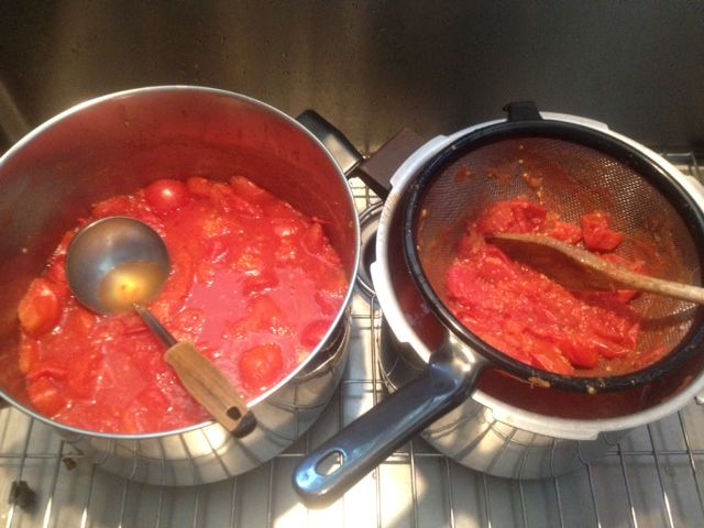

    This is my 32" Krauss sink, and at 5'5" I don't find it to be too deep for comfort. I love my faucet with the sprayer right on the end. It's not too high for form or function.
    You'll probably want a plumber to come and reconfigure your drains and connections and well as connect your DW. Depending on how old your sink connections are, you'd want a plumber anyway to install the newer connections that are so much better than the old ones we had from 1971.
    I don't hear you saying you want an air switch for the garbage disposal (that little button on the right). You really, really want one of these - one of my favorite things. Just imagine being able to turn the GD on and off without dripping your wet hand/arm over several feet of counter! Our GD switch used to be over there near where the toaster oven is now.
    Although a 32" sink sounds huge, and it is big, it isn't so big as to be silly. I find it the perfect size for soaking dirty pans before I wash them and for all kinds of prep.
