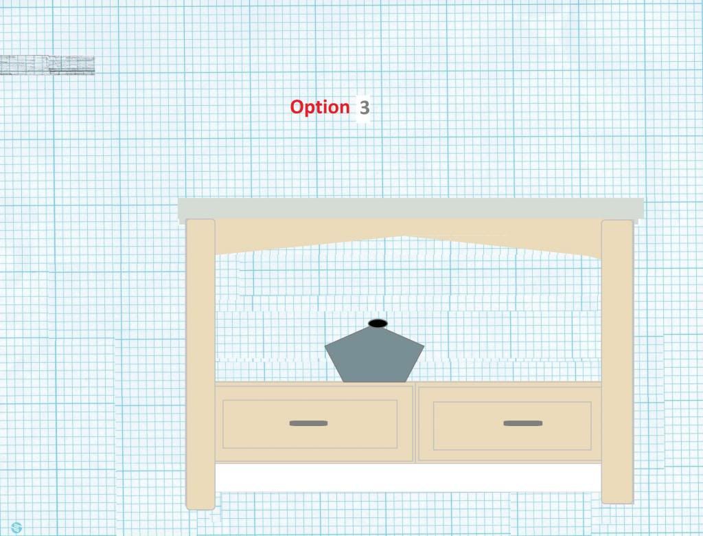

The picture below has been my layout inspiration and I am going to end up with a similar layout. I have room for a 24" X 51" island. I fear a traditional island with base cabinetry in that small size will end up looking like a little box plunked down in the middle of the room.
I love the openness of this work table and I'd love the function of the open lower shelf as I'm going induction & plan on splurging on a couple Le Creuset pieces & I think they'd look great there and be in easy reach.
But, I hate to give up all that other possible storage space.
Its hard to say if I really need the storage in the island, I am gaining tons of storage compared to what I have now, but you can never have enough right? Plus, in a worktable design like the picture, you can't put an electrical outlet there, can you?
I'm using a custom cabinet shop, so they could build any design I come up with.
I'd like something to still give an open feeling, and have open storage for the cast iron, but hopefully still have some handy storage, and the option for electrical run to it.
I sketched this design, not sure I love it. Any ideas?

    We will also have a narrow island in our kitchen due to space restrictions. Given the choice, we would have gone deeper. But, that wasn't to be. So, our island countertop will be 29" total. Since we are going with custom cabinets, I think we are making the island 26" deep all together. We decided that part of what makes a narrow island look plopped is when there is toe kick all around it. So, we are having toe kick on just the side nearest the sink (my working area) - the rest of the island will have sides that go down to meet the floor and have a finish strip of some sort.
    The plus to having an open table like that is that you could put it on wheels to make it easily movable. The minus is that you can't have electricity going into it. You *may* be able to have an electrical outlet installed in the floor, but I'm not sure how functional that would be overall since many kitchen gadget cords aren't that long. Do you NEED electricity there? As it turned out, we did because that's where my mixer will live...so, we are going with an enclosed "standard" island.
    If you go with the work table, I'd add a shelf in the center and have your Le Creuset on display on the two shelves. I think the one shelf like what you have shown might look a little sparse since you have the sides built to be closed in for storage.

    We designed a work table and, if we didn't have a gorgeous 8x10 rug in the kitchen, I would have done the "hollow leg" option so that electrical could be run up from the basement creating the illusion of a freestanding table but with permanent function.
    I agree with the second shelf if you have the larger, closed sides.
    I like the work table and think that they are very handsome in a smaller space. My work table is 30x50 and the drawers open from either side (so that after washing up, cooking tools, knives, etc. can be easily returned to where they live from the clean up sink). The base is also largely open so that it keeps the room feeling spacious.
    I cannot wait for my work table to be delivered (we got a 12-16 week lead time - so either in June or July). I am so ready to be officially *done* with my kitchen - although it performs beautifully even without the center work table.

    it's nice when one END is available to rest things on/and retrieve from. You have the 2 cabinet sections blocking both ends. I might make one cabinet of a larger dimension on one side only.Try 18-21 inches wide, full height to the top- the 2 drawers would each be slightly smaller using the remaining inches.Under the drawers the shelves would have access from 3 sides....so handy that way...

    I vote table, I also like the look a lot better than island for a narrow solution. I think with the closed storage on both sides the solution you designed, while beautiful, is going to feel very "islandy."
    If you really can't give up the closed storage, what if you had open storage on both sides and closed in the middle?
    But I love your inspiration pic best and think it would look lovely with le creuset on one or two shelves.
    I do have stuff on open shelving near the floor, and it gets FILTHY (darn cat hair), so personally I'd go with a shelf a little bit higher than pictured.

    Thank you all so so much for your opinions. I do think I need to just study my layout more and be sure I have a place for everything, if there's stuff that still needs a home, then I think it may be foolish to go work table. But I suspect I have room for most stuff, I feel like I really want to do the work table, but with a little bit of storage.
    I just sketched out herbflavors idea (thank you!) and 2 other ideas I had, if anyones looking please weigh in on if you like any of these or have other ideas.
    Can I do that hollow leg thing? Never heard of that but sounds perfect, Im afraid Id regret not having an outlet there.

    I like your first choice best, so you have closed storage option.
