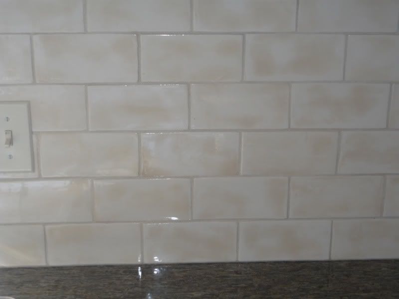

    Subway Ceramics are the only truly "authentic" subway tiles I have found that permits the very thin/fine grout lines one finds in subway tiles from the 1920s (Note that the grout lines are thinner than on Johnney's picture above). But at about 20 dollars a square foot, they are pricey. They come in a regular gloss glaze and a crackle finish that looks a little faux to my taste. They do not have the hand-made ripple effect of Johnney's subway tile above.
    I hope this is helpful. I couldn't tell from your original post if you were looking for "hand made" rustic tiles or an original looking early 20th century subway tile.

    I can't tell from that photo if the tiles are irregular, or if it's just a crappy install. It looks to me like they are regular subway tiles that weren't all installed straight and even, and there's grout that didn't get wiped off, hence the look.

    Umm, that's edlakin's kitchen, and saved in many people's clippings as a nice example of a period install... :)
    I think her tiles were handmade and thus might not have been perfectly square, but what's making them look irregular is the narrow grout line, more than anything else. Using a 1/16" grout line shows every little variation in the tile, which is why a lot of people who want that look use the Subway Ceramics or other similar rectified tiles to get perfectly straight edges. We couldn't afford that, so just got the straightest stock tiles we could. Fine, but not perfect. If you want to do a teeny grout line, though, you want to avoid irregular tile---you won't be able to set it properly because of the variations. (Many of the handmade tile places say 3/8" grout lines or bigger for their tiles.)
    Basically, get Subway Ceramics or its brethren if you can afford it, and if not, get very regular machine made tile. (American Olean and Daltile are cheap and both work for installs like this.) In either case, use a 1/8" grout line or smaller (1/16" is best IMO)---what will get you the "old-fashioned" look, more than anything else, is the narrow grout line with darker grout. Good luck!

    Johnny153 - I love those handmade tiles. Who makes them and what color are they?
