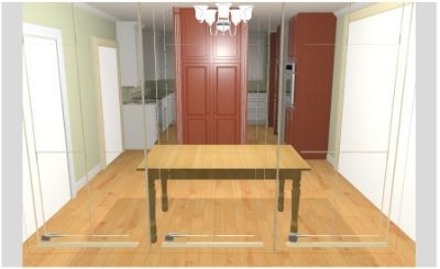

For context - here is a 3-D view:

I like B better. You read center-of-the-run because part of the wall is hidden behind the other run.

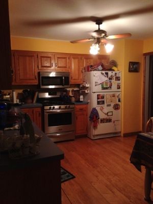

Current ktichen from the DR doorway.
