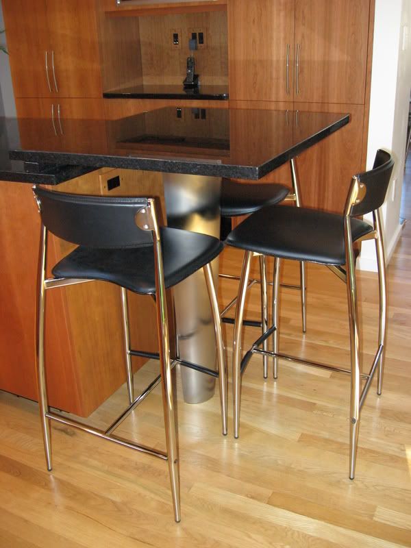

    I showed the outlet on the front of our island above, but we also put two on the back just under the overhang. They are close enough to the side of the island to satisfy code (less than 12" for a cord to get to the counter top) but the overhang makes them less obvious. The back there has a panel (shaker) so we put them inside the frame of the panel.
    Because of the thickness of the panel plus the thickness of the cabinet side, the shallow box doesn't intrude much into the cabinet (a pull out cabinet facing the side of the island but this would also work in a cabinet facing the front):
    I wonder if the baby proofing outlet caps can be found in black - noticed for the first time in this picture that the white ones kind of defeat having black outlets to make the outlet blend better. Today the solution would be to put in the outlets that deb mentioned which plug the holes when the plug is pulled out. Code where we are requires those for now but our remodel was 6 years ago.

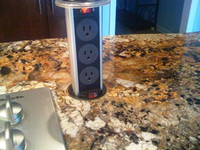

    You might look into a "mockett". I did that on my island. However, my granite is a very busy granite, so it really isn't noticeable.
