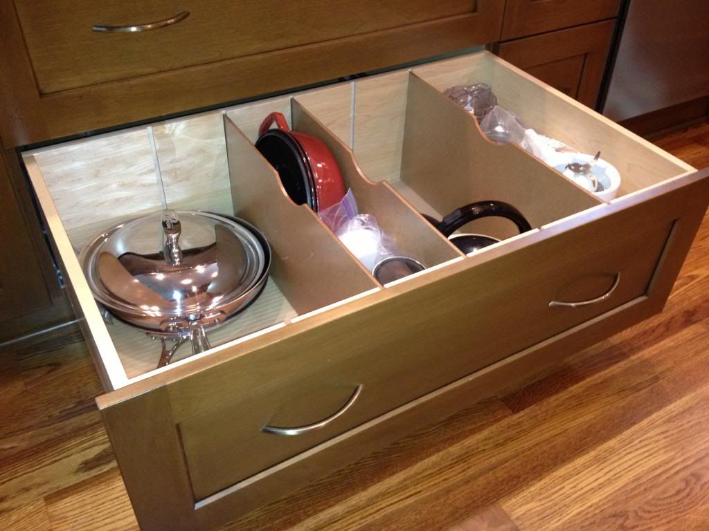

    Not under a cooktop but the same idea-
    middle drawer of a 30" frameless cabinet.
    These are not adjustable, (mine and predate when I could do that easily)
    Spacing is 3-1/2 to 4-1/2 clear between and dividers are 4-1/4" (4-1/2"
    max) high to allow lids and (11") fry pans to tilt enough to clear and
    saucepans to sit front to back. It also allows much easier access than
    full height dividers. Drawer box sides should be full height if at all
    possible. Larger fry pans, square sided sauteuse, woks, etc. get stored
    elsewhere. Usually with tray dividers in base cabinet though the first
    two can work in the top drawer of a frameless caibnet. (I hate stacking)
    Nowadays I spec adjustable in most brands, the one brand that I can't
    do that with we put them in with pocket hole screws and fit them to the
    clients actual stuff.
