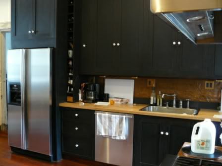

    I have ss behind my range due to design considerations but chose copper for my backsplash material everywhere else; after 5 years, I've never looked back. It's as maintenance free & indestructible as anything I've encountered while looking good through it all. I use a lot of limes & always have a few pin-points of 'clean' copper showing but due to the uneven patina look, they don't stand out.
    FYI, my cabinets are black/green & aesthetically, copper provided contrast without being overwhelming. The pictures I've seen of coated copper that stays shiney are beautiful but I can't imagine any copper remaining in that state without pampering or daily polishing.
    This is an old photo showing the contrast:
    This post was edited by antiquesilver on Wed, May 22, 13 at 23:16
