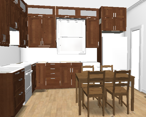

The ceilings in my kitchen are 112" (9'4") high, and I'm not sure what to do with them. I plan on using 39" Ikea Adel Medium Brown cabinets, so I have 16 inches of space above the cabinets.
I've come up with the following options:
A) stacking the cabinets. I tried to do this using the Ikea software but I couldn't get it to look right. I also had some trouble with cabinet options.
B) Soffit (L-shaped or perimeter)
C) Soffit + Crown Molding. Do stained cabinets look good with crown molding? Getting white cabinets is also an option, especially if white will help me achieve a more custom, built-in look.
D) Lower ceiling by a few inches (kitchen is currently completely gutted with no ceiling)
E) Leave ceiling at 112" and use the 16" of space above cabinets for storage
F) Tray ceiling
What would you recommend? Would a soffit look weird with my refrigerator sticking out by 28.5 inches?
here are some pictures:

    If it were me, I wouldn't do a soffit. I would either do stacked, probably glass fronted, or leave it open for storage.
    Also, yes, personally I think crown molding looks great with stained wood, you just stain the molding to match.

  • Tile
    9 years ago
    Okay, so no soffit then. I'm so glad I made this post in time! I had no idea that some people consider soffits undesirable.
    I can get the horizontal glass cabinets to line up with the cabinets on the west wall, but I will need two fillers pieces for them to connect with the cabinets in the northwest corner...unless I should be connecting them diagonally? Do I need to connect them at all? Would it look bad if I left a gap in the corner?
    I also can't figure out what to do with the cabinets above the fridge.
    Should I consider a different color of cabinets? Is it easier to achieve the "built-in" custom look if I used white cabinets that are easier to match with paint or crown molding?
    Here is a link that might be useful: http://kitchenplanner.ikea.com/US/UI/Pages/VPUI.htm?LoadDesign=8bf8333e60ed4994bff77dfdf111ee09&UIContext=Kitchen&IsSharedDesign=1

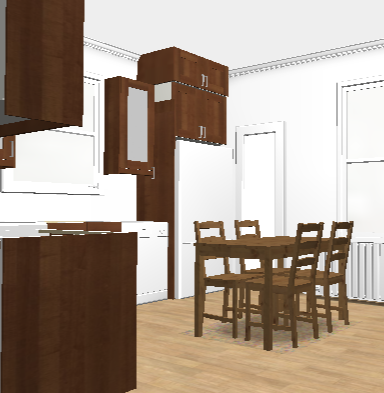

  • Tile
    9 years ago
    @julia42:
    I also don't mind some space above cabinets...but do you think it's possible to have too much space? I have about 16"
    Is this what you meant by popping up the cabinets above the range hood and fridge?

  • Tile
    9 years ago
    Are you guys sure stacked cabinets would look better in my particular kitchen?
    It doesn't look right in my pictures:
    Perhaps my kitchen is too small for stacked cabinets? It's only 160 sqft...

  • Tile
    9 years ago
    threegraces, unfortunately Ikea only offers 30" and 39" horizontal cabinets :-(
    I was able to get the uppers to line up properly by getting rid of the corner cabinet (leaving about 1 ft of dead space). How do you think this looks?
    I still can't figure out what to do with the area above the fridge...
    Edit: some additional modifications...What do you think?
    with solid instead of glass doors
    This post was edited by Tile on Thu, Apr 24, 14 at 13:14

  • Tile
    9 years ago
    I made another major change to my layout...What do you think?
    I got rid of the upper corner cabinet because I want to do the open shelving thing in my previous post.
    Here is a link that might be useful: http://kitchenplanner.ikea.com/US/UI/Pages/VPUI.htm?LoadDesign=78ebccf9449844bc9e629a9917861771&UIContext=Kitchen&IsSharedDesign=1

  • Tile
    9 years ago
    Here's my attempt to approximate the open shelving look using Ikea's software...The shelves (just open boxes) would have to be custom made:
    I think I may give up on the floor to ceiling look for now...I don't know how good it will look in my kitchen, and I'd have to find someone to build the boxes for me. I hope it's something I can add on later.
  • Tile
    9 years ago
    @Ranton: Do you mean something like this?
    Ikea sells large panels that I can use to encase the fridge. I wish I could fit a tall pantry or pullout cabinet to encase the fridge, but I only have 8 inches between the fridge & wall.
    What do you think of this panel over the sink that connects the cabinets to the left and right of the window?
  • thepeppermintleaf
    9 years ago
    Could you do one glass faced door on either side of the sink instead of 2 on the left? The one on the left would open towards the stove, which might make dishes easier to put away from the dishwasher.
  • rantontoo
    9 years ago
    Yes.
    I do not like the connecting board; It looks like there should be ceiling moulding closing that gap at the top...looks unfinished to me.
    If you have 8 inches to the wall, does IKEA make a full height pullout or an under-counter one that could be double stacked and hacked? I have seen them in various widths from 3 to 8 inches online...again not sure what IKEA offers.
    I would take the cabs as close to the ceiling as possible with IKEA's configurations and trim any gap with moulding. If you do not like that look, then just buy the tallest cabinets possible and leave the space above open as long as it is something like 12 inches minimum so it looks purposeful. If the gap is too short, then I would use trim/moulding for more finished look.
