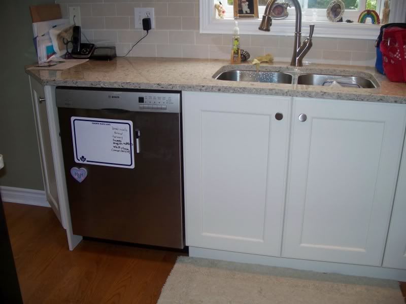

Hi has anyone had a new Bosch dishwasher installed in a new kitchen and had large gaps on either sides? It does not sit snug next to the cabinets. Has a black decorative strip, and sticks out like a sore thumb in my new kitchen. My contractor said he would look at it, but I am hoping someone has some ideas...
Thanks! Love the rest of my kitchen, this just looks bad...

    Picture, please?
  • coco4444
    Does yours look like this? I don't mind mine, although in this pick it still had to be raised a titch...
  • lizzie6
    It does look like above, I did take a pic with my iPad, how can I post? Sorry, kind of new with commenting. Very good at browsing! Lol

    Bosch, Miele, and Asko are not actually 24" wide. Instead they're something like 400 mm or about 23 and a bit. If your dishwasher spot was sized for a non-European dishwasher, there will be a bit of a gap. I think people often get a strip of filler wood to match their cabinetry rather than using the black gap filler.

    Have your cabinet installer install scribe molding (SM) on the cabinet to the side of the DW. It's a thin molding designed to disguise gaps where the cabinets meet the walls and he should already have a bit of it in scrap on hand. It's not a big deal to correct, and it SHOULD be corrected as the issue is not merely a cosmetic one. Any gap between a DW and the adjacent cabinetry can allow sound from the motor and pumps at the rear to escape outward into the room. I've had installers adhere a thin foam product the the adjacent cabinet that was hidden by the scribe molding and that also helps with the quietness issue.

    As usual, live wire got it right. My Miele was installed in a mis-measured cabinet --24" vs 23-5/8" (other dinos here might remember that particular cabinet saga but it was long, long ago). When we ordered extra custom trim pieces to correct other really bad issues I forgot about that strip. Next time there's a carpenter in the house, I'll have one put in and just paint it out.
    But, as a result, the Miele is much less quiet than it should be. It's certainly not noisy but when we got it right in our apartment it was even better.

    Why not just push the cabinet(s) on either side closer to the DW? And if necessary, put a color-matched vertical filler strip at the end of the cabinet run where it meets the wall? (if the cabinets end in open space, enjoy the larger walk-through opening).
    Although it would make sense that non-US dishwashers are 60cm (23") instead of 24" wide, if you actually compare the dimension specifications, you'll find they're all about the same. Only the front-to-rear depth is substantially different on most European (but not Korean) brand dishwashers.
