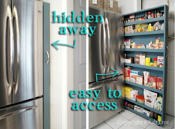

    I wish there was room for one in my kitchen!! Check this out:
    Here is a link that might be useful: Pull Out Pantry for Small Spaces
