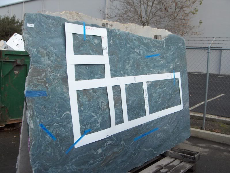

Our job took 3 slabs so 2 of them were a bookmatched pair and the third one was the next one in sequence (the one that had its rough face against the rough face against one of the pair. Since its polished face was 4 cm away in the block of granite from the polished faces of the other two, its pattern was very similar to theirs but there was some drift.
Our L counter has a sink leg that was longer than the long dimension of the slabs and longer than twice the short dimension. The other leg was longer than the short dimension of the slabs. That means there was no way to lay it out on the slabs so that all seams were bookmatched. (If both legs are no longer than the long dimension of a slab, they can lay it out with a diagonal bookmatched seam in the corner. Our kitchen fabricator doesn't like to do the diagonal seam, but in our case it didn't matter because of the long leg.) The only way to do our counter with only one seam was for the seam to be at the sink or dishwasher. Fabricators seem to be divided on whether a seam at the sink is good or bad, but over the dishwasher is more of an issue because there is no cabinet front for support.
We wanted the seam at the sink because it let us have just one seam and our fabricator preferred that as well. Our granite is 2 cm with a plywood underlay so it is well supported at the sink by the plywood and cabinet.
Our granite is very active, but the grain doesn't have a strong direction - in some areas, it slants across the slab and in others it was pretty swirly. We spent a couple of hours with the fabricator laying out the templates on the slabs. We were doing granite backsplashes and wanted a good match between the counter and backsplash and also had to fit long pieces for our window sill and counter outside the kitchen window. We chose a placement where the two sides of the seam were in a swirly part of the granite. I can see the seam when I look for it, but I don't notice it otherwise even though the color match at the back of the sink isn't perfect.
Recently we had a surround made for a new fireplace from the remnants from our kitchen. The top and one side came from one piece and the other side came from another piece because those were the only remnants long and wide enough.
I think the fabricator did a good job of positioning the pieces on the remnants so that the seams aren't jarring even though the long direction of the top piece was parallel to the long direction of one of the side pieces on the same remnant. BTW, the left and right side pieces came from the same part of the slab on the two slabs that were back to back - you can see that they are close to mirror images of each other around the white smile-shaped mark but the darker area a foot or two below the "smile" shows more differences.

Sailordive, the two sides of your "bookmatched" seam may have come from two book matched slabs, but it doesn't look like the seam was bookmatched. To create a bookmatched seam, the pieces need to be laid out on the two slabs so that the two sides of the seam are at the same place on the pattern in the two slabs.
For example, here is one of our slabs with the template for part of our L on the top of part of the slab. The end that will be one side of the seam is on the right (just above the upside down white smile).
Here is the bookmatched slab for that one. You can see that it is a pretty close mirror image of the other slab. For the seam to be bookmatched, the other side of the seam would need to be positioned in the same spot on the mirror image as on the other slab (again just above the upside down smile), but the pieces won't fit that way and the seam is the end of the short bit almost touching the top edge of the slab. (The bottom of that slab is the backsplash for that side of the counter so we have a great grain match on that long very visible area.
