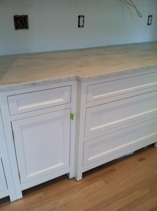

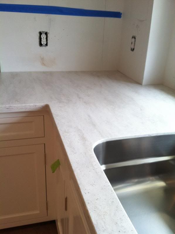

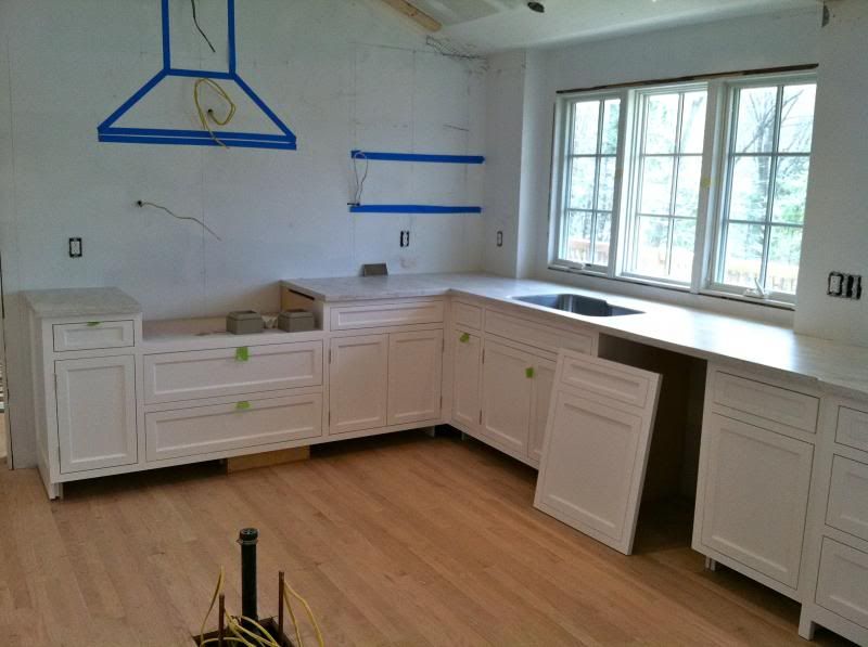

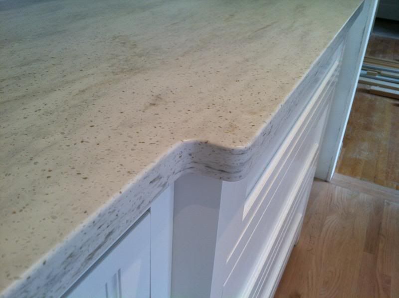

My Corian Sea Salt countertops were installed yesterday. I was so nervous about how they would actually look in place as I was working from a very small sample. But I absolutely love them and am very happy with my choice. The only problem is the corner radius. When the template guy was here I specifically said I didn't want rounded corners and to make them as square as possible. Well, they arrived rounded. I don't know what the radius is, nor did the installer--he guessed 3/4". He told me this is standard and there was not much they could do now. Because these countertops have been delayed due to a variety of issues, our remodel has been significantly held up. So I thought I would live with it. However I keep looking at it and wondering if they could come back out and cut the corners on-site. My biggest issue is the way it looks on the built out hutch cabinet. Any opinions? This has been so stressful (we've been living in the basement since September), and I hesitate to start any new battles, but I don't want have big regrets down the road.
 photo IMG_0968_zpsd61c1482.jpg photo IMG_0970_zps32fd9dc8.jpg photo IMG_0972_zps7c307711.jpg

Extremely frustrating! Isn't "square edge" on your order/specs?
RE: Countertops installed--love them, but have an issue.
Pros to the corner you have: Less likely to chip and less likely to bruise hips.
You probably should have given a specific radius to have much recourse.

Maybe this is as " square as possible" as they were willing to do them. Sharp inside corners cause a certain amount of material stress, so then they matched the outside radius to the inside one. I think a sharp outside corner could definitely be something you banged yourself on, too. I actually think it looks fine--the radius is fairly small.
Thanks for the feedback. Snookums, it wasn't addressed until the guy came to make the template. We had a detailed conversation about it. He was pushing rounded but agreed to an "eased" corner. I don't know what happened during fabrication.
The cabinet guys are here delivering the appliance panels. They think the inside corners can be squared off on-site, but the outside corners would stay as is. That would be okay with me, I think. I don't mind the outside corners being rounded, and agree that it's probably better from a "bumping into" perspective.
I've got a call into the company, but they're from the Boston area and things are really bad there right now. Two of my kids live near Cambridge, so I'm also trying to keep a perspective about this whole counter thing--I just hope everyone stays safe.
Then that inside corner would be different from your other inside corners? I'm not sure that would look right or with the rounded outside corner. Be sure to find pictures and think that one through.
Looks fine, it's a beautiful counter and coloring, but I know what you mean. Give it a little more time so you can adjust. That's often all it takes.

I like this better. Less likely to chip and poke you when bump up against it.

From the Corian Installation Manual:
INSIDE CORNER CONSTRUCTION METHODS
One of the major fundamentals in the fabrication of Corian® is that all inside corners have as large a radius as possible, with the minimum radius being 1/2” (13 mm).
It then goes on to explain what you have to do to treat inside corners to avoid the stress risers that Pal cited.

Thanks everyone. Angie, that info was very helpful. I'm going to embrace my curves!

FWIW, I think your countertop looks much better and much more hip-friendly than if you had small-radius corners.

"When the template guy was here I specifically said I didn't want rounded corners and to make them as square as possible. "
I much prefer the rounded corners, as they are shown in the photo. A sharp corner is a "poison arrow" in Feng Shui, and I avoid those whenever possible. With a rounded corner, you won't have it catch (stab) your hip, or that of a guest, if someone brushes or stands against it. It doesn't say "danger!" to me. If I was looking to buy a house and it had sharp corners, I might even walk away from the purchase and not realize why. (yes, I'm always thinking about resale)
The rounded corners also soften the overall look of the cabinets, with their sharp, true 90-degree angles. Personally, I would leave it alone.
