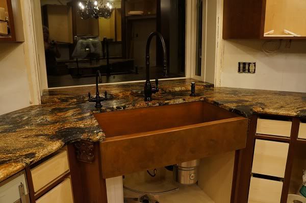

My new sink is a 36" single bowl with a right rear drain. This past week my GC installed the GD, water filtration system and the insta hot. Everything is tucked off to the side and I've got tons of room under the sink now. I've never had a sink cab with tons of room before. I've no idea what I'll put there!
Not a great picture but you can get an idea of how much room there is under the sink.
