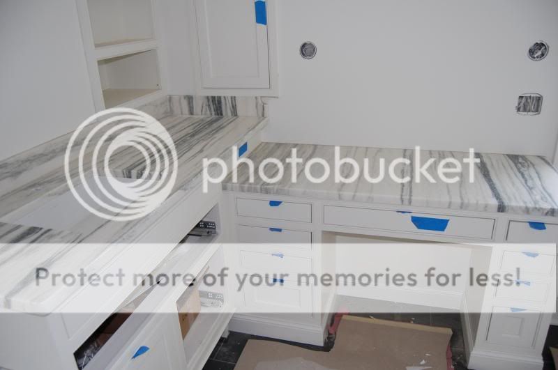

    Here you go. All running the same direction.

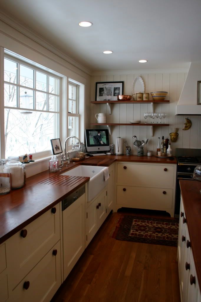

    I did find a picture of Pirula's heavenly kitchen. It's a cherry counter but does have pronounced grain which was run lengthwise on both legs. I wonder if a more quiet part is in the corner if yours would work to run it lengthwise. They did not seem to worry about that here and it still looks beautiful.
    She has linked her album in another thread, so here it is again. I think it looks fine and more natural this way.

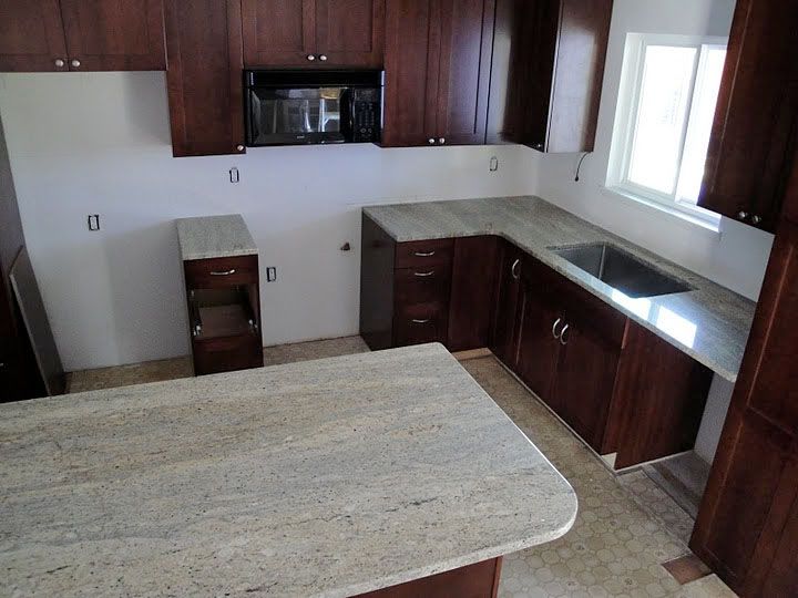

    I didn't have time to read all the responses. My kitchen is similar in shape, a U with an island...... someday.
    My photos show that the sink wall (widest expanse) are side to side, no seam in the corner, which leaves my smaller counters on either side of range front to back.
    Counter left of the range, front to back, and if I use a stone on my island, it will run side to side lengthwise. I haven't had my coffee yet so I hope this makes sense. If my words don't convey, here's photos.
