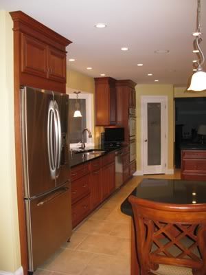

Mine fits very, very snugly in the space designed for it. However, the doors protrude out into the room interior past the counter, and when they are opened they swing past the cabinet (i.e., if the doors were flush against the cabinet and true counter-depth, the cabinet would have to be about 2-3" wider to accommodate them opening). I'm not explaining this very well and I don't know if a pic helps, but FWIW:
P8260373
It's possible that your cabinet person is trying to make sure that the doors have room to open, but at the same time when the doors aren't open you'd have a black hole to either side of the fridge.

Thanks blue, that does help. A picture is worth a thousand words! I spoke to my appliance salesperson who even double checked 2 spec sheets and the floor model display and he tells me that I only need 36" interior space between the panels and that the 38 5/8 is what is needed for the doors to open 90 degrees but that is as you describe-past the opening on the outside of the box for the fridge. Thanks again!
