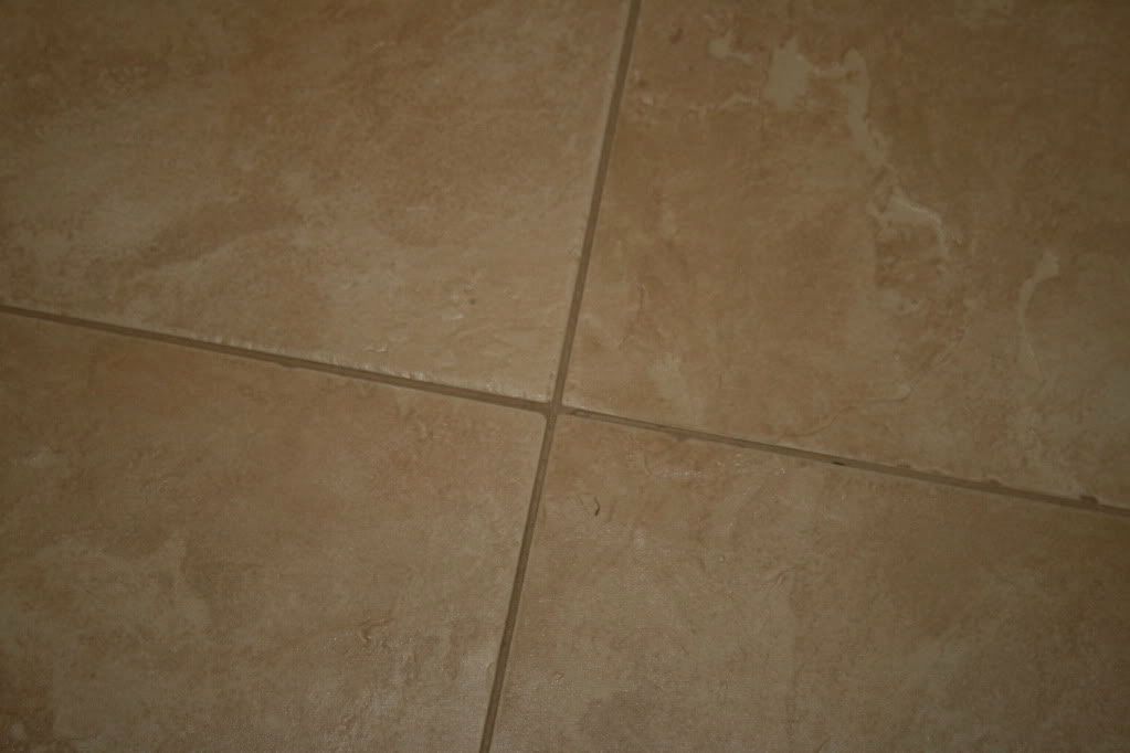

    DH applied the Aqua Mix Enric'N'Seal several days ago and it really works!! Just wanted to give an update as several GWers have e-mailed me with problems like I had at first with a grout way lighter than the sample stick color. Here are the pictures. First is the floor before the enhancer/sealer was applied. Grout way lighter than we wanted.
    This is the floor when wet. You can see how the grout darkens up.
    This is the floor after the Aqua Mix has been applied. Much better. We like it!

    Do what we did. Go back to the tile store or wherever you purchased the grout. If tile store they will contact Laticrete to resolve issue like they did for us. If big box store like Home Depot or Lowe's-stores we have where I live-you may have to contact Laticrete yourself. Putting on the Aqua Mix Enhance did help but over the years of washing/cleaning the floor the grout has lightened up a bit. It's been almost 10 years now and I'm ok with how the grout is with my tile. However don't know if I'd ever use Laticrete again.

    Yes, we did and they contacted Laticrete. Laticrete gave us the Aqua Mix Enhance at no charge to us. Problem resolved when we applied the enhance to the grout. It darkened up and we were happy. That was back in 2010. Over the years the grout has lightened up so we probably need to apply the enhance again.
