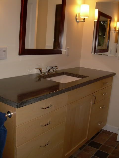

Ok, mine aren't anywhere near as impressive but here goes:
http://i243.photobucket.com/albums/ff48/Sbcichocki/DSC01864.jpg This is a pour in place form. We haven't done a pour in place yet, hope it turns out well!
http://i243.photobucket.com/albums/ff48/Sbcichocki/DSC01869.jpg This is right after pour and smoothing. Hubby smoothed every half hour for about 8 hours.
http://i243.photobucket.com/albums/ff48/Sbcichocki/DSC01875.jpg This is the next day. It will stay kinda gray till the grinding/polishing (28 days after pour)
http://i243.photobucket.com/albums/ff48/Sbcichocki/DSC01876.jpg This is a vanity we did last month. It was done with the Cheng method of making a mold off site (melamine) and using the bottom for the top. We waited 28 days to grind/polish because we wanted very little to no aggragate to show. We polished only with a 1500 grit pad on a wet grinder. Then I sealed with multiple coats of bee's wax. Not sure how I will seal the kitchen counters. I love the bee's wax look, just not too sure how it will stand up to kitchen wear.

RE: concrete countertop pix
Desk
Desk
Vanity
Alright, I think I figured it out. Sorry to double post, I don't know how to go in and edit my original post. Sorry pix are so big. (dang, I just sound sorry today don't I!!!)

Silverraven-- I really like the bathroom vanity. Was that a poor in place top as well? What did you use for the sink cutout -- rigid foam insulation, and if so how do you cut it so perfectly?
Vanity was an off site pour (in a mold), using a melamine form. Yes the sink cut out was pink rigid foam insulation. Hubby used a jig saw with a fine tooth blade. Actually cut way better than we had hoped. Much better than an electric knife. Then he used a palm sander to smooth, and clear packing tape around the outside of it so the concrete doesn't stick to it.
So far we are happy with the desk top texture. You can't really tell the texture in the picture because of the 'haze' that forms on it till it is ground/polished. I will post pics of it after we have done that. It will probably be 28 days though. They say if you don't want a lot of the aggregate showing you wait that long to grind/polish. That is what we did on the vanity, it seemed to work.
Oh, one thing about pouring off site (in a mold). Remember, you have to carry that darn thing in to put it into place. That stuff is heavy! The vanity was 200 lbs of concrete. And it is awkward to try to move. Make sure you have enough friends that are willing to help if you do it that way. That is why we are doing the pour in place for the desk and kitchen counters. Just toooo heavy to carry!

Hi Silverraven,
What do you think of the Tung oil for the concrete? I've never used it.
Just finished our second bathroom.
It was a comedy of errors, which mostly translated in a lot of extra time. Can't seem to get any good pictures of the surface. The only aggregate can be seen around the sink, otherwise you see very little of it.
The mirror in the background is now going to be replace with a full wall mirror, cut out around the outlets and lights.

overlyoptimistic- Wow! Love the countertops! That is what I wanted mine to look like. But, we can't always get what we want..........
We aren't using our kitchen yet, so I am going simply by test pieces. So far lemon juice, tomatoes, lime juice just seem to pull the tung oil off, but after I put more on goes back to looking good as new. I left a sample out in the rain for a few days, no water spots or damage. It definitely stays dark better than just bees wax. What sealer did you use?
S
