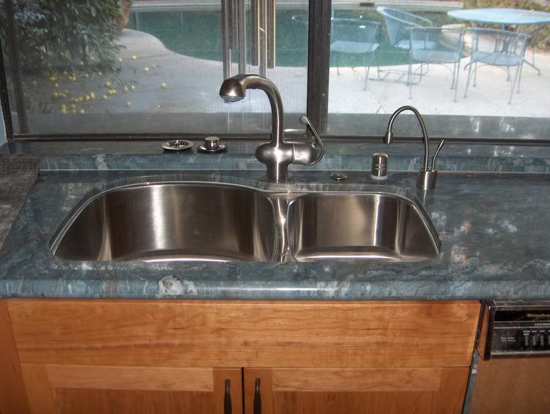

We are redoing a small kitchen for my awesome mom! She has never had anything "fancy" in her kitchens and she absolutely LOVES granite. I want to surprise her. She has a Kohler double basin drop in stainless sink that she likes and is in great shape. She is only 5'2" and seems to be getting smaller :) so, maybe that would be better for her than an undermount sink.
Will this look bad? It is a very small kitchen and she doesn't want a dishwasher, yes, she is very old school! So she does her dishes in the sink.

    Part of the "look" of granite is an undermount sink. You might explore the option of a bar or veggie sink.which are often shallower. We have done projectrs where the customer used 2 smaller undermount sinks with a granite rail in the middle. costs more as there are 2 undermount cutouts but at least you can consider the option and it ;looks very nice.
    A 1st rate fabricator will machine a depression in the center rail so if the faucet is passed over the center rail the water runs into the sinks instead of possibly down the front of the cabinet. finishing the depression in the rail can be challenging because it requires the fab shop to grind the top of the rail and then bring the polish back which can be difficult.
    Also note the front rail width (front to back) affects the ergonomics of the sink for a shorter person. you'll want the fabricator to make the front rail as narrow as possible.

    You might also be able to have her existing sink undermounted. Many drop-in sinks can be undermounted. It will make the sink a little bit deeper, though.

    Since she hand washes in a double basin sink, show her pictures of a low-divide sink and see what she thinks. We use our DW but always have several things to hand wash, and a double equal low divide sink is fantastic for that. It's one of the most useful changes we made when we renovated. The divider is plenty high enough to fill one bowl for washing.

    As someone who never hit 5'2", I'd have to say faucet reach is what gets me; depth isn't a big deal. If the sink is set back more than she's accustomed to, you might need a faucet with a longer spout.

    I'm 5' 1" and on top of that my arms are short (my torso is pretty much normal height). We have a deep undermount (10") sink and I have no problem reaching the bottom.
    Deep sinks may be more annoying for particularly tall people who don't like having to bend over to reach things on the bottom.
    Like Fori, the reach to the faucet can be more of a stretch.
    We made sure to get a faucet with the handle on the side, not the back, got a sink where part of the sink is shorter front to back like ardcp's. Then we had our sink mounted as close to the front of the cabinet as our granite guy would tolerate (because the granite rail in the front of the sink could be fragile if it was too narrow) and put the faucet also as close to the back of the sink as practical.
    That way I can reach the faucet comfortably. We also put in an airswitch for the garbage disposal next to the faucet. The old switch was on the wall towards the corner of the L which made it hard to reach for me.
    Putting the sink closer to the front edge of the cabinet also helps with being able to reach the bottom.
