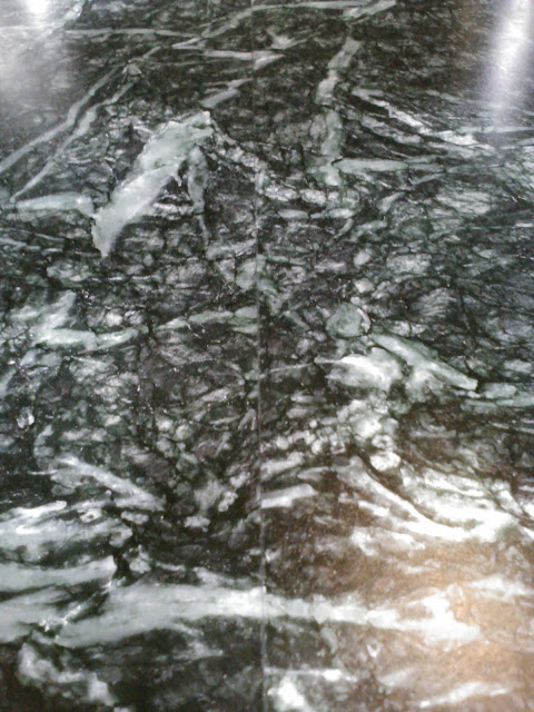

Honestly, I believe it depends on the skill of your fabricator. Here is the seam on my island/overhang and I literally had to search for it to take the picture.

remodelfla - Thanks for sharing - that is a beautiful stone - what is it? I guess it really depends on the fabricator. We considered getting soapstone from FL Joshua and then I would feel much more confident, but the soapstone was a huge step up in price and I just couldn't justify it.
I will have to look at some of my fabricators seams and decide.
I guess that means you are against the bookcase idea?
soapstone and joshua
Well... mine is Monsoon Wave soapstone fabricated and installed by Florida Joshua. He didn't stock it at his yard so I flew up to Jersey (incorporated it with a trip to see both my boys who live in NY), picked out my slabs, and had them shipped to Joshua. I live in So. Fla. so he had to take a couple of trips down here to measure, fabricate, and install. It went perfectly and even though it was a HUGE splurge for me; I would do it again in a heartbeat. It is beyond functional, beautiful, and takes a beating without issue. I can go without waxing for a couple of months and fall in love with the kinda washed black denim look of it. Then I'll get in the mood to shine it up and fall in love again with the vibrant sea glass colors that run through this stone.
If you have the chance to use Joshua... it's worth every single penny and more.
