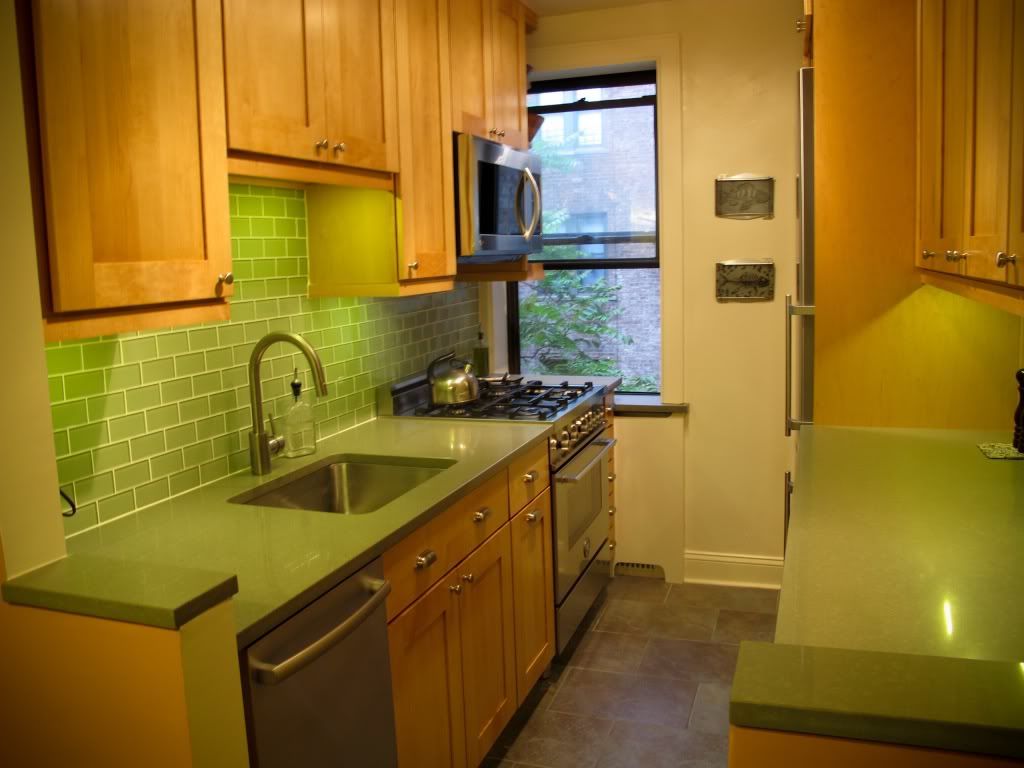

  • Circus Peanut
    Liebherr!
    Their standalones are true counter-depth and they have unique hinges that do not extend past the fridge box, allowing you to integrate them without much sticking out past the cabinetry. LOVE ours for function and efficiency, as well. They have dual compressors like the Subzero, without quite the price tag.
    They also make built-ins, but we found the freestanding 30" model to be fully aesthetically sufficient.
    Here is a link that might be useful: Liebherr
    This post was edited by circuspeanut on Thu, Mar 7, 13 at 9:34
