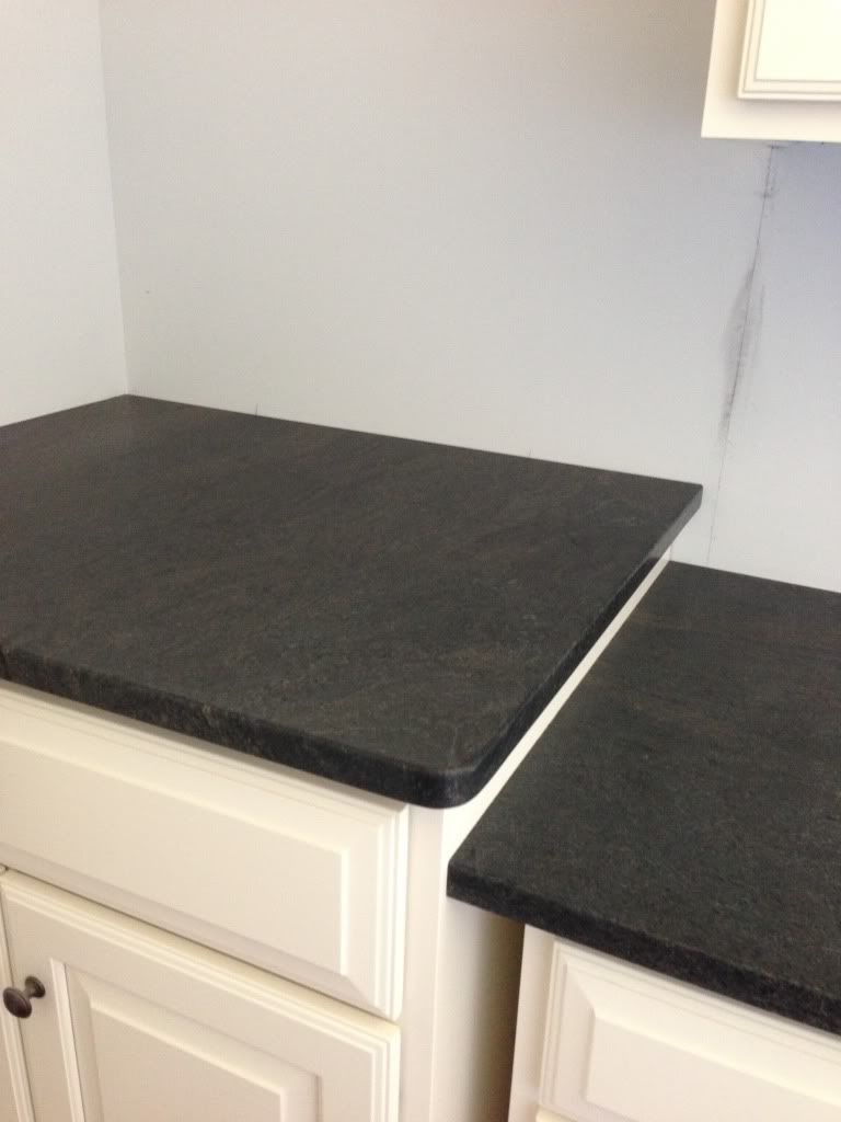

What kind of soapstone would you say this is?
threeapples
It's not been treated with oil or wax, just leathered

  • gwlolo
    Looks like leathered granite. Don't believe soapstone can be leathered. Too soft
  • threeapples
    You can buy leathered soapstone all over the place.
  • Circus Peanut
    That high-gloss shine on the countertop edges also makes me wonder whether this isn't some kind of serpentine rather than soapstone proper. I also wonder about the leathering -- to the best of my knowledge, it's hard to do on soapstone.

  • bcafe
    I have seen leathered of varying degrees at Dorado's CO shop. I have a hard time believing that stone hasn't been treated with some kind of oil/wax.

  • threeapples
    This is my stone. It was labeled soapstone and was originally not leathered. I'm interested in what type it is just for my own general curiosity.
  • athomeinvagw
    Maybe Jucca? If there is no oil or wax on the stone then it probably has an enhancing sealant on it, otherwise it would be much more dull. The shiny edge does not mean it is not soapstone just that it was polished more than most.

  • bcafe
    It still looks a lot darker than mine before any oil touched it. I don't know your variety but can't they tell you what you chose?

  • live_wire_oak
    I looks more like granite than soapstone. Do you have any scraps left over that you can test?

  • gbsim1
    Has it always appeared dark and black? If so its either a granite or its been enhanced. It would have been a very flat matte gray before you oiled it. And it will take numerous oilings before the chameleon like process slows down.
    All that really matters is that you like it but its important to find out what it is so that you can take care of it properly. Granite will need to be periodically sealed and you wouldn't want to oil your granite!
    Have you decided to keep the unasked for leathered finish? If not then I assume they'll be fining you new slabs anyway?
    And the mesh is a nonissue. My soapstone has mesh and so did a granite we used in our former house.

  • threeapples
    Just learned it is Brazilian soapstone with granite-like properties because of its hardness compared to other soapstones. It was untreated in the stone yard.
  • threeapples
    Just heard from the fabricator. They said this soapstone is more granite-like and, therefore they sealed it. I told him I didn't want it sealed because I wanted to be oiling my soapstone. He said oiling this would not work because it is more like granite and you cannot oil granite. The stone yard said it can be oiled. Ugh!!!
  • Circus Peanut
    Do you have a record somewhere of having ordered it unsealed and unleathered? Seems to me this mistake is the contractor's, unless you failed to specify these details somewhere in the contract?
  • gbsim1
    I'd bet money that you don't have soapstone.
    Tell your GC to work it out with the fabricator.
    You expected smooth silky soapstone with a changeable amount of blackness/gray based on your oiling etc. you got a leathered sealed granite.
    Has the fabricator ever worked with soapstone before?
    And other than the small vein in Virginia that is no longer worked and a minuscule amount from India, ALL soapstone is Brazilian. See if they can tell you a type or who the supplier/importer was.
  • threeapples
    Just heard back from
    Mont. it is in fact soapstone. They talked to their buyer. Mine is not granite. The fabricator is going to use acetone to take the sealant off and then I can oil it. Nobody admits to leathering it so I'm really confused about the texture. I'll see what happens once the acetone is off and post back.

  • threeapples
    Good grief, Mont maintains it has no name other than "Black Soapstone" and they said it was slightly textured, not completely smooth. Maybe I didn't notice its texture? I'm not sure, but will decide after they remove the sealant.

  • karin_mt
    Three Apples, glad you've got it worked out. For the record, anytime the stone yard says that any rock has "granite-like properties" you should give them the stinkeye. Terms like that seem destined to confuse customers.
    What you want to know with soapstone is the exact hardness. There is a number for this - ask for a number. Don't settle for an explanation that involves a mythical hybrid of rock types that is geologically impossible.
    Anyway, this is water under the bridge because it sounds like you are all set. So my post is just a PSA for those shopping for slabs. :)
