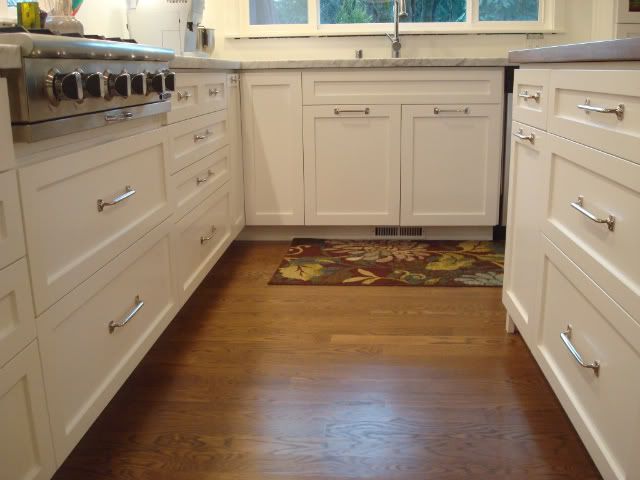

    I've got 2 under my BS range top. It's a heavy piece. The drawers don't go back as far as other drawers so there is plenty of room in the back to run the connections.
    not that you need more photos to show your guy that it can be done, but here you go
