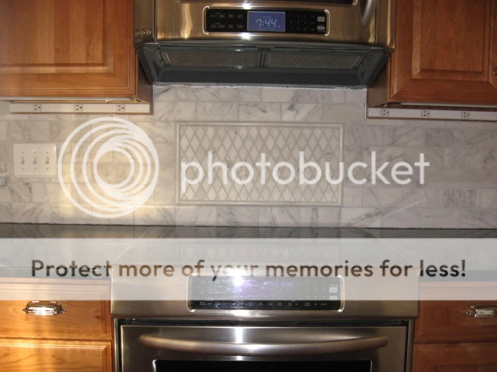

Peonybush:
I love your backsplash! What are the details such as name/color of your tile and where did you find it?
RE: Those of you with marble backsplashes ...
Peony,
I really like your hardware, too
Rose---here is the tile I used...3"x6" Pietra Art/Classic Mosaics China White Honed Marble from Florida Tile. The grout is Laticrete Perma Color in Color-Sauterne. I don't know what it is was sealed with but I have no staining at all.
I searched a long time for that tile and no way was I backing away from it even though it was marble.
I saw it at a couple tile stores..the tile on the board shows pure white but there is actually slight color variation to the tiles which I like.
Bookworm--the hardware was an absolute steal on ebay. They were less than $2 per pull. DH wanted a pull that he could get his fingers behind and these are great. They have a bit of an industrial look. They also look like they are secured by 2 screws on each side of the pull when actually it's 2 screws from the back into the pull. We love them. I looked on ebay and don't see them but I'll look deeper..the seller had hundreds of them.
