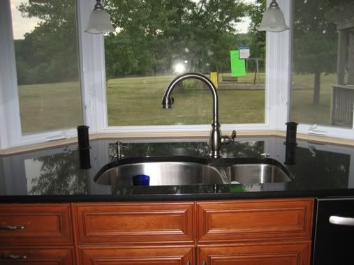

  • Buehl
    15 years ago
    clinresga, it's not necessarily "gimmicky"....it was the only way we could meet Code without having to build a raised platform in front of the window just for the outlets. Our GC and electrician wrestled with several options, none of which would have been anywhere near as aesthetically pleasing as these Mocketts.
    So for me, a necessary and the best aesthetically pleasing option. No problems yet, but as I mentioned earlier, we don't use them often. We did use them during the Christmas Holiday to power the lights on our mini-tree that was in the window. No cords hanging down from a wall or hanging over a countertop edge where they could get caught on something.
