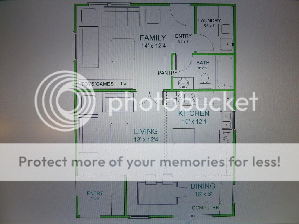

    Here's a 3D Home Architect drawing that I just did of a different arrangement. If you like the general idea, it can certainly be tweaked. Also, the measurements may be slightly off since all of yours aren't indicated, and I know I don't have the windows and doors exactly right. But you can draw up a more correct version yourself.
    I think it solves several problems. It gives you a nice living room, gets the kitchen off to the side, and you can move the table and benches over to the left (I made it 6' x 42", and don't know how much it should hang over the benches, but others will know this), if you want more kitchen cabinets along the right wall.
    Also, the opening to the bathroom is more private and the laundry is larger with room for a laundry tub or sink. Moving the door between the LR & FR over makes both rooms better, IMO.
    Anne

    OMG, Anne, thank you! I've been struggling with the bathroom and laundry room, and you've made it much better. I like what you've done with the kitchen, too. I agree that the door farther over is better...maybe I got too greedy with the kitchen space.
    We do have guests quite often - both of our families live out of town, and friends come, too. We recently moved very far away from our parents, and I want them to feel comfortable enough to come for longer visits.

    I'm glad you like it! Here are a few changes, along with some possible furniture arrangements. I made the kitchen a little larger, and moved the dining table and benches to the other side, because that seems less crowded and easier to access, and it seems like it would be a great gathering place for conversation or kids' projects. I'd put drawers under the entire bench for storage--costs more, but so much better than raising the lid of the bench and having everything in a mess below.
    If you can get a rectangular trestle table with 3 leaves, it can be extended to the right a couple more feet, but the computer desk would have to be a little smaller, or in the corner or be switched to being under the window to the right of the fridge for people to slide onto the bench from that side to use the table. The MW might be able to sit on the counter to the right of the fridge. What is the measurement from the bottom of the window sill to the floor on the front windows?
    The island is now 5' long and 36" deep, with storage from both sides.
    BTW, which way is south on the drawing?
    Anne

    do you need a tub in the bath..seems a shower would suffice . the guest would feel more than adequately cared for. I'd eliminate then the "jut out" part of the bath into family room. Make One entry into the back bath/laundry.. Say,the exisiting laundry door is used,then do an internal pocket door for bath side...put the utility sink out of the straight on position and use a stacking wash/dryer..... with space savings,the wall for the pantry can be pushed over to allow deeper storage and get a closet for clothes storage or some shelves for the "guest". With one less swinging door and stacking units and a shower stall you can probably have some back pantry..shelves or cubbies, actually in the laundry room. This is still the back entry for your home: another option is make a straight line from back door to passage to front living area..you'd have to reposition the range but you'd gain some wall space and enlarge the living room. Right now, the pic shows a really oversized kitchen /island and dwarfed "livingroom". Are you really thinking the family room is the "livingroom" except when guests are there?

    I love jimandanne's plan! And take it back about the u.

    I'm enjoying working on your plan, and have another version that I don't have time to upload right now. I'd forgotten about the piano. So if you put it on the left side of the dining room, you could have the bench just along the front wall (not along the right wall), and an 8' table (that's with the leaves) would spread out nicely with room for chairs on 3 sides. But I had to reduce the cabinet between the fridge & DW to 12", no computer desk, and the island becomes 4' x 4'.
    I meant to ask before--what climate are you in? I'm used to visiting friends in Georgia, who have no coat closets, but up here in the north, we obviously need them. So as herbflavor indicated, there are lots of ways to do that back entry combination. With young kids, I'd want a larger laundry, but YMMV. I just put a tub in the bathroom because it was easier. :o)
    So once you decide what your priorities are, you have some flexibility here to come up with a nice plan.
    Anne

    Anne, you're wonderful. Actually, you all are! We don't actually have a piano - that's just aspirational for my toddler :) And we're in Texas, so don't need coat closets, but do need a landing strip. I plan for a bench with coat hooks next to the front door, and maybe some more hooks in the laundry room. I'm from Michigan, too, though, so am very familiar with coat closets.
    I'm head over heels with the laundry room. I can envision my someday-teenage son coming in the back door and stripping off whatever sweaty clothes he's wearing and throwing them in the wash. That's realistic, right? :) In any case, I think the pocket door will usually be open, except when I pull it shut to hide the mess from company.
    I don't need a tub in the bathroom, but would like a good-sized shower, since it will only be our second bath and will be used daily by at least one of us.
    I made a slightly more detailed plan that includes some more information about what is already there (e.g. built-in in the family room, pull-out sofa) and using furniture I already have. I also ended up with a 4'x4' island, and there are pillars on one side of it that might be necessary to hold up the roof once we take out those walls! If I don't need them, I would love to do an overhang with two stools.

  • jimandanne_mi
    How about hooks to the left of the front door, a closet to the right, and a low bench or ottoman to the right of the door to the bedrooms that faces the front door for people to sit on and take off boots.
    Can you show us a plan of the existing layout so that we can see where walls and doorways are now? That way, we can possibly make suggestions that would involve less work with the walls.
    Anne

    Anne, that's not a bad idea. We currently have a tall but shallow shoe holder on the left with hooks above for keys. There are only about 11" on that side of the door, so it's a bit limited. I could definitely fit a closet to the right of the door, and maybe a bench where you suggest.
    k_b, no more than one kid in the plans for us, but I do know he'll get bigger and take up more space. Although with all the big plastic toys, it's hard to imagine! The house is little, but I kind of get a high from figuring out how to make the most of a small space. We also have a big shed and a garage, so anything that can go outside does.
    Here is the existing layout. As you can see, there isn't any storage planned in the main room (the family room was an addition several years after the house was built).
    After the kitchen/public space, we'll be moving on to the bedrooms - we plan to put built-ins in the master, and get rid of the powder room in favor of more closet space. The closet in that hallway is currently devoted to HVAC, but we're hoping to move that up into the attic at some point. Some of that space could be used for the bathroom in there, but I've been unable to figure out how making it a foot or two deeper will help add storage, which is what we really need.

  • jimandanne_mi
    I'm still new at posting photos, and I have some 3D photos of the plan in Photobucket, but can't get the html code to post, so I'll try to explain.
    After looking at your original, it seems clear to me that, at the least, you probably will have to have a post where the corner of your existing kitchen wall is in the middle of the room. I think that's about 3' from the corner of the island in your latest plan.
    My unpostable plan shows the addition of a 12" deep x I suppose another way to deal with it would be to leave out the 2 new cabinets that I just mentioned, put the 36" wall section mentioned, and put a bookcase facing the living room side with a picture or mirror over it. That would help to define the LR, and also block a lot of the view into the kitchen as you walk into the LR from the entry or bedrooms. However, it will look like a post from the FR doorway and the DR bench opposite it.
    Maybe someone can come up with a better idea!
    Anne
