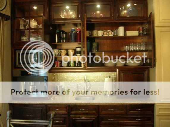

Here are our 3 shelves in 30" uppers ... let alone a 34 or 36! Never for a moment would I have wanted or expected less shelving. In the right hand cab each shelf is 10" high. Fits mya 12-piece place setting plus all our regular glassware and stemware no problem. On the left I adjusted the lower shelving even smaller for coffee cups so it's 8" bottom, 9" middle, then a taller space for big water bottles at top.
So whatever way you go, ensure your cabinet maker gives you 3 shelves and that they are adjustable ... regardless of your cabinet height.
