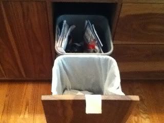

We have exactly what sjhockeyfan posted in a 12" interior width cabinet. We completely enclosed the trash compartment and have a drawer on top for dishtowels.trash/recycing photo IMG_0139.jpg
