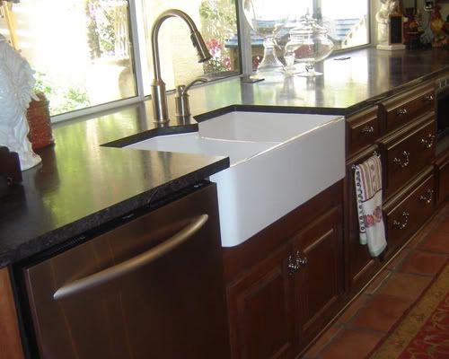

  • Missy Benton
    Maybe these help? Like I said in an earlier post, I don't have any seams in my kitchen, but I do have two sinks with faucets. All cuts looked perfect to me at install. My granite is polished, not leathered/honed.
  • Missy Benton
    And another one of my main sink and faucet.

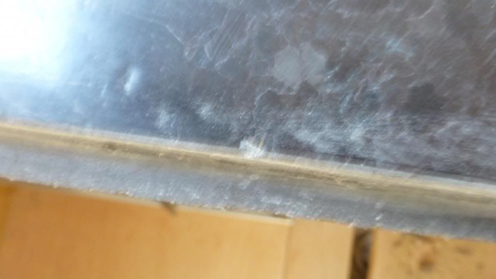

  • stogniew
    We have a member of MIA over to evaluate the install and he pointed to us what we already knew, but we were told we are lucky the owner is willing to work on it and is trying to fix it. He said many in our area will not even bother to work on improvements- I am guessing this is happening because we only paid for material thus far.
    That said, we discovered yesterday (after the MIA memberâÂÂs visit) that the granite is not attached to the cabinets- or at least not along the entire perimeter. I think it is not attached to cabinets at all, but I cannot say for sure except for the peninsula, where there is a visible air gap between the cabinets and the stone. The granite is sitting on a shim that is placed in the corner of the peninsula (next to the power strip visible on the photos below) and the entire countertop that covers the 52 inch by 30 inch peninsula is above the cabinet tops connected to the cabinets only through that shim in the corner.
    The âÂÂair gapâ is caused by the difference in slab thickness between the two pieces of granite that sit on this chains of cabinets running along the wall and ending with the peninsula- the one lifted in the air is skinnier, so it is shimmed above the cabinets to be in level with the other piece ��" these two are connected by the seam shown above. There is also shim next to the seam.
    I will get back to the MIA member who was here to have him give me feedback, but would like to hear other fabricators ideas whether such situation is normal?
    ShouldnâÂÂt the stone be sitting on the cabinets along the entire perimeter ?
    the shim is next to the power strip- hard to see because it is black as the power strip itself.
