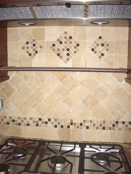

    I have a shelf behind my cooktop and love it! My hood has warming lights towards the back and this shelf gives me a really handy place to put things I want to keep warm. It's a great place to rise dough also. My teapot sits up there a lot when not in use. This shelf is from IKEA.

    ccoombs1- can you tell me the name of your Ikea shelf? Or at least the depth so I can find it? It looks great. I was going to tile in a nook, but I may do this instead. Love the idea of bread dough rising there!

    ccoombs1- can you ALSO tell me the height you mounted it from the cooktop? How did you arrive at that measurement?

    oooh - I like the idea of the tea pot being there....ccombs, is it the kitchen shelf with bars across it (not a solid shelf)?

    Staceyneil, it is the Grundtal shelf that IKEA sells for $14.99. It's 31 1/2" long and 10 1/2" deep. I didn't want the mounting brackets to show so I cut some large square holes in the drywall put some wood blocking inside the wall for the shelf to mount. Then I carved out the face of the drywall so the front side of the bracket is flush with the face of the drywall. Then I just tiled right over the brackets.

    The shelf is appx 19" above the burners. It gets a little warm while I am cooking, but not hot enough to burn you if you touch it. And it's very easy to wipe clean. As far as how I determined where to put it....that was easy. I wanted 3 rows of 4" tile above it so there would be room for my diamond mosaic pattern, so it's 12" down from the hood. My tile pattern changes from diagonal to straight directly behind the shelf. That was a little challanging to do!! lol!

    Wow, creative! I have those shelves in my nook, and hang pots from them. Wondered what you had done re the brackets.

    No wonder that looks so good, Ccoombs--you thought that through!
