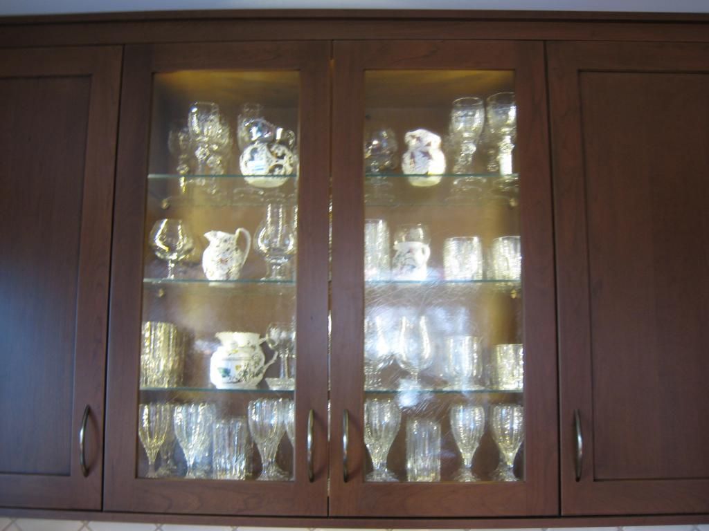

Please help! I know I saw a picture on here with a glass front cabinet with wooden shelves and there was led lighting running vertically down both sides of the cabinet to light up the cabinet.
I want to do this in my cabinet. I thought I bookmarked the thread but now I can't find it.

    My butler's pantry cabinet has them. I didn't do them inside of the ones in my kitchen because the glass panel on the end made it so you could see the lights from the breakfast room.

    I finally found the pictures I saw--they were from an old post that I can't seem to locate but I had marked someone else's clippings and it was in there.
    Does anyone know what kind of lights these are?

    I believe those lights may be Kichler's--recall considering them. That set-up is quite expensive. I used the led tape lights at 2700 lumens (soft white) purchased from a specialty lighting store. My cabinet is only 36" wide so ran a strip up each side, and they meet in the middle at the top. I believe the transformer is on top of the cabinets. The tape was installed at the very front so that one edge of the tape butts up against the face frame. The shelves were installed the usual way with no modifications. The cabinet is very well lit. Only the top lights are seen if one is standing against the counter and then looks straight up so this method works quite well at keeping lighting out of the range of vision almost all of the time. I'm going to light a 48" wide open shelf cabinet in the familyroom and will use the same method except angle a triangular-shaped wood strip in each corner to disperse the light over a wider area as jakuvall mentioned above.

    mine are the maxim starstrand, they are on tape.
    see link for a picture
    Here is a link that might be useful: lights

    We put in vertical LED tape lights that dim. We do have glass shelves but they would work with wood shelves.
    We were supposed to use standard lights but they were so back- ordered that they gave us the triple bright lights for the same cost.
    Kimberly Triple Bright LED tape lights
    They did require a transformer to dim them
    3000K - so more white than yellow

    Did you install Loox 2013 warm under your cabinets as well or only in the vertical cabinets. If you did so, do you find the lights intensity sufficient under the counters or is it on the dimmer side? The reason i ask is that i am looking at the Loox 2013 as well, but i see that there is a high intensity Loox 2015 product that is much brighter. The LED's are bigger and spaced apart instead of being smaller and closer as in the Loox 2013. Which also concerns me with uneven lighting rather than uniform lighting as in the Loox 2013. also, did you install these on the underside of the light rail or on the underside of the cabinets itself and can you see the LED bulbs shine/reflect off your countertop surface? I am quite confused. If you can shed some light on this, that would be really helpful. Thanks so much.

    In cabinet are 2013 with NO track, under cabinet are 2015 in a track. Track is set at an angle of about 30 degrees if I remember. (Have to check drawing.)
    For some people the 2013 put out enogh light to keep them happy. I typically use the 2015.
    Since counter is not very dark reflection is not very noticeable. A deeper track is available that cuts the reflection of individual bulbs. No dimmer was used, we intended one but they are a bit annoying in paractice. The direction you rotate your finger on the dimmer changes. Haven't found a solution to that yet.
