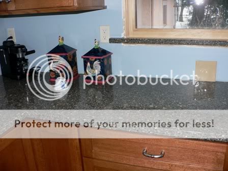

  • heidihausfrau
    I have had my Cambria for a couple of months. Love it so far! I clean it with a soapy cloth or just winded and a paper towel (per installer). I will have to be on the lookout for chips. Don't have any, and like others, I would be really disappointed to get some.
    Here is a close up.you can see some resin, but it is just like the sample and I find it interesting to look at. In person, you can see down into it--kinda dimensional.
    This was before backsplash. The sticky note marked a scrape from delivery that they just buffed out.
