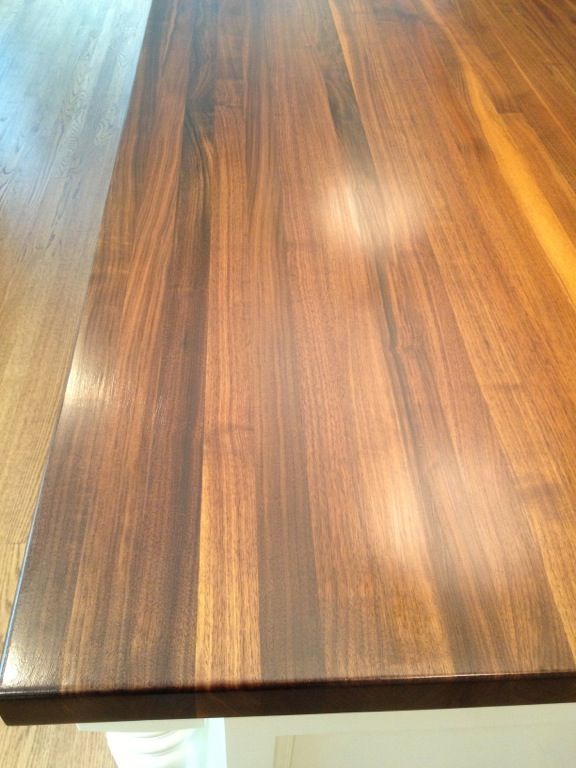

Hey All,
We got our top in December and we already had some major scratches from our ceramic dishes most likely (which I've now sanded down the bottoms so they are smoother). To the best of my knowledge, my cab maker did 3 coats original and one satin but I think they buffed it out after- (not really sure)
Anyway, maybe b/c it wasn't fully cured it seemed to scratch easy. Lately it hasn't scratched nearly as much.
I spoke to Waterlox a few times. They told me spot fixing doesn't work well with the Satin finish. Today I followed their directions. (cleaned, "sanded" with 0000 steel wool, and then put on a coat of Satin. I started using a lambswool applicator but switched to a cotton cloth. I was very careful to view it at all angles and make sure surface wasn't bubbly and didn't have overlapping lines, etc...
Now that's it has dried it is streaky. From many angles it looks good but we get a lot of light and you can see lines in it and it kind of looks dull or cloudy? When you look at light reflections in it there is inconsistency in the gloss level as well. The woman at WL said I shouldn't have used a rag- especially with the satin- and that I may not have used enough WL and possible "overworked" it.
Anyway, I'll be doing this over but now have read many people online saying the Satin is much more difficult to work with due to the dulling agents in it that make it less shiny.
Now I'm just thinking I should stick with the Waterlox Original which people say is easier to apply and sets up better. Any Thoughts?
I tried to take photos but they don't capture the problem.
This thread just shows pics of my prior scratches.

  • 2LittleFishies
    24 hours after application here are some good examples of the issues...
    And some angles it looks good:

    Update--- 4.5 hours since application and except for a few stray fuzzies it's looking good!! I'm shocked and crossing my fingers. So far no streaks- and no little bubbles. I think putting on more product did help also not using a cloth to rub in. It may not be 100% but at least good enough that I won't have to take off and do over. I figure every year or 2 it might be something I do if scratches get to be too many...
    I REALLY hope this one is good! I wonder if I can get rid of the fuzzies in any way. Probably not.

    Just wanted to post some new photos! It looks great- just like when the cab guy brought it here! A few tiny stray fuzzies but I can live with them. The color never photographs well...
    I'm so relieved but yesterday I could cry and thought it might be too big of a job for me!

    Hi All! I barely remember doing this but it just seemed to cure fine- no streaks. No issues and still looks great!
  • Loretta Seeker
    7 years ago
    Your island top makes my heart skip a beat!! Would you be willing to post a picture of how it looks today, three years after sanding it down? I'd love to see how it looks after normal use.
  • 2LittleFishies
    7 years ago
    Hi! Just took these today! I love this top and the Waterlox is amazing. Scratches tend to disappear. There are some baby ones but you can't really see them!
