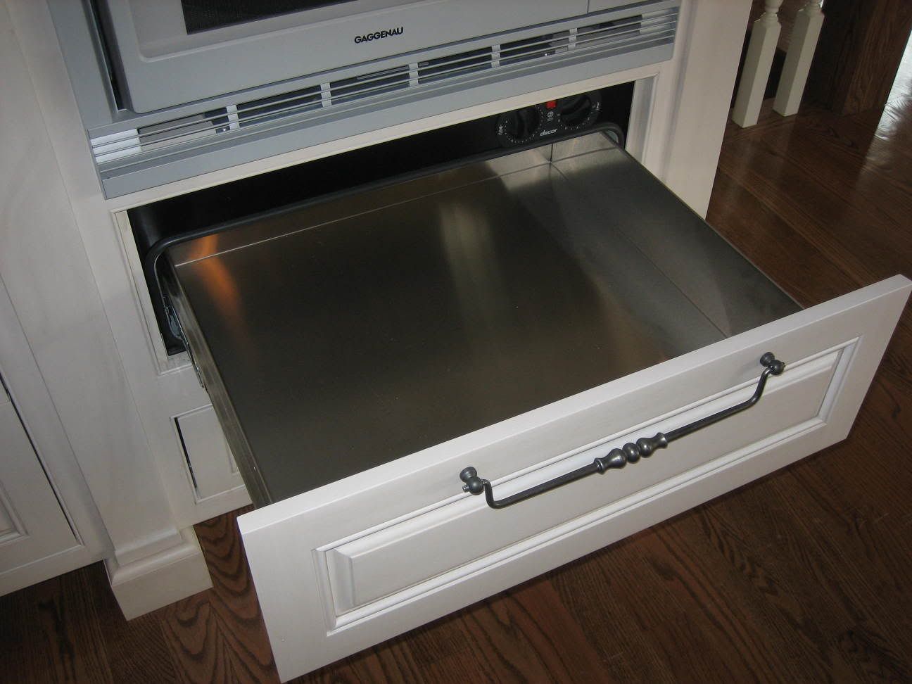

    My wd is a 27" wide Dacor. My oven cabinet is 24" deep. My wd is 7 yrs old and it is full depth and it fits into that cabinet fine and is fully inset with a panel.
    Your KD has to plan carefully and it requires a small frame to be built on each side of the chassis as in the picture.
    Would I recommend you do it? No. It looks beautiful, but in hindsight I would rather have a wd that vents which you will not get with this Dacor. I think the SS wd will look great next to the wolf and you will have a venting wd.

    If its not done carefully, it won't work. The chassis has to sit deeper than normal into the cavity, then a frame constructed. The panel has to be the right size and so does the cutout.
    As far as humidity control...think about it. If the drawer is totally closed into a cabinet, how could humidity be allowed to escape? The drawers that are SS have a venting mechanism on the outside that allow you to open up the vent and vent some of the humidity out..which will keep your food from getting soggy. None of the inset drawers will allow you to vent.
