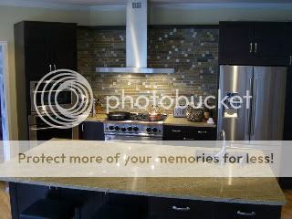

I have mine all on one wall, but from what you're describing, I'm not sure it'll help you. Personally, corner appliance garages aren't my favorites. I actually don't like very many corner solutions, so I did away with mine. The ones I like are the ones that run straight to the wall and look like a tall upper sitting on the counter...But with those you can't wrap cabinets around to the adjacent wall.
Anyway, here's my rangetop, microwave, fridge wall. You can see that I did make my microwave cabinet deeper than the rest.
RE: Anyone have fridge, micro,& range same wall?Pics? Cabinet Dep
I have that set-up.
I also have 2 different depths
of cabinets on the same wall.
Appliance area. Uppers 12" deep, except fridge upper, it is 24" deep. Lowers 24" deep.
Cabinets to the right of the appliances are all 12" deep.

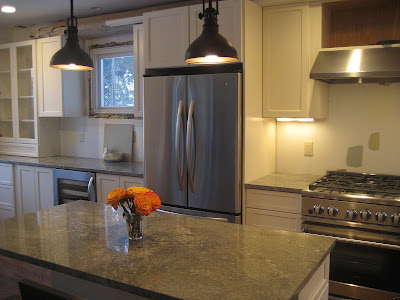

I have a similar set up to caligal.Same measurements of cabs. Can't help you with the appliance garage though, since I don't have one.
From pendant lights
