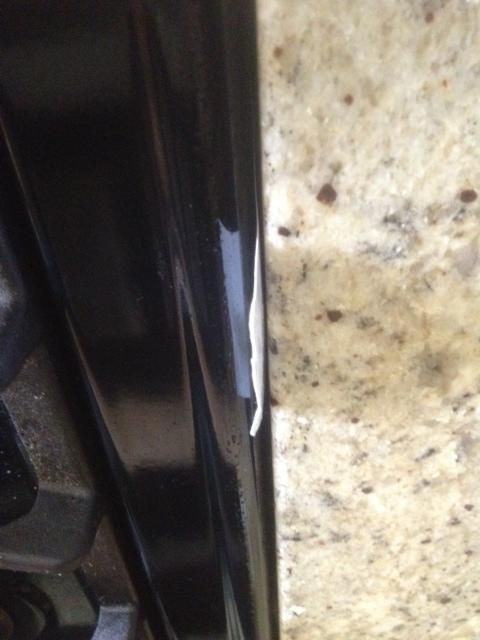

    The edge of our granite is flush with the side cabinet next to the stove. It's very close - the white thing sticking up is a business card. I think I could have put 2 cards in the gap, but that's about it. The fit is tight, but the stove can be readily moved in and out.
