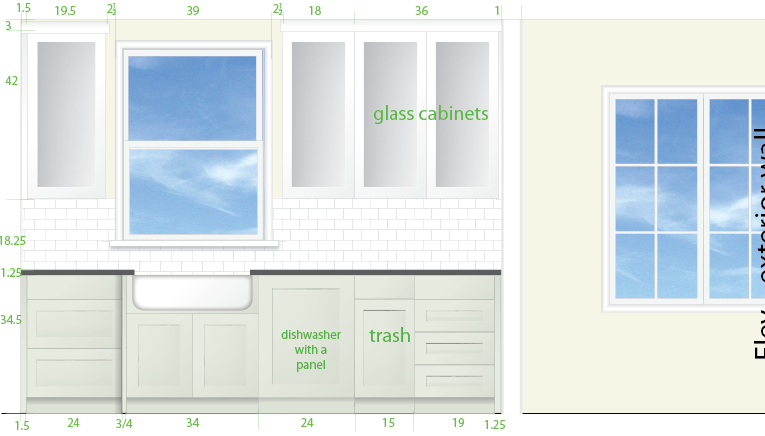

So this is approximately how that wall would look if I keep the wall and just make the opening bigger.
RE: What's would you suggest for kitchen/dining room transition?
Are your ceilings 99" then? Because you aren't showing the proper heights for things if your ceilings are 96". You would need to do 39" tall uppers in order to have 3" of molding at the top. And it would be better to do a compound molding that would allow the top molding to "float" in case you have unlevel ceilings. Do a simple light rail too for your under cabinet lighting.
GreenDesigns:
My measurement are off, I know. I've been going back and forth with different cabinet brands and options and adjusting the drawing too many times. I have to fine tune it. Just looking to get overall feedback on the layout.
The ceilings are 98.5. I added an extra 1/2 to the molding at the top and forgot to compensate. I agree with you completely about the compound molding. And I do plan on adding the light rail under the cabinets.
Do trash pullouts come in 15" width? I know the one brand I was looking at only makes it in 18", but then that end cabinet would get really small.
To piggygack onto GD's comment, yes all those things add up to a ceiling height of 99" PLUS 7 rows of tile means each tile is about 2.069" high, not the "timeless" 3" (x6" high) subway tile.
Here is the corrected version with more accurate measurements.
