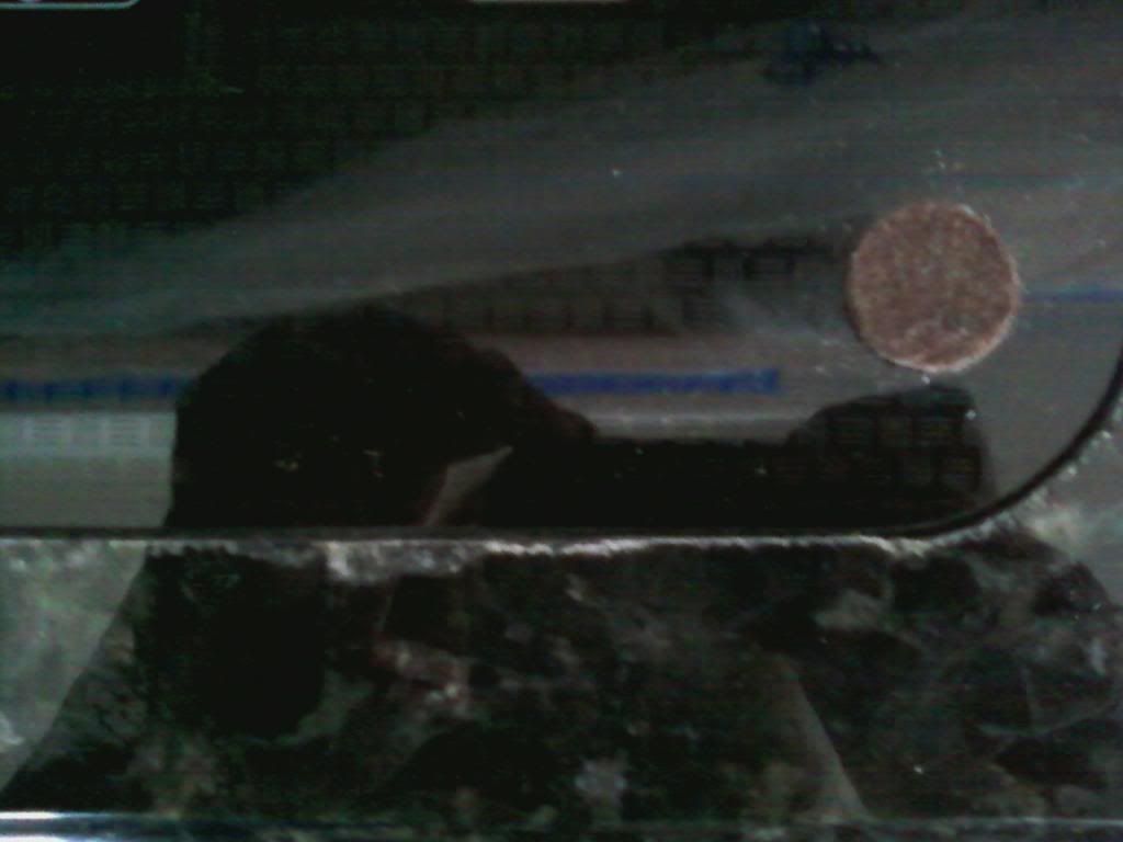

My beautiful Volga Blue granite was installed yesterday. While the granite itself is lovely, I am concerned about the seams and cutout for the cooktop. The seaming looks extremely jagged and of variable width. Around the cooktop, there are several gouges, one of which is shown below. Is this fixable, or is this a disaster? Granite fabricator is coming out tomorrow to see it, so I need your help! TIA
Granite seam:
Cooktop cutout:

    Will the cooktop's lip cover the jagged edge?

    beekeeperswife: no lip--it's a frameless cooktop, so what you see is the entire piece. In fact, he mentioned when he was templating that it would be easier if it were framed. Perhaps that should have been a red flag to me?

    seams are mediocre at best. It's possible to do much better on Volga Blue. also, looks like the seam adhesive is silicone. Epoxy seams are much superior and have been the standard in mist areas for at least several years.
    the exposed chip at the cooktop can be repaired. should not have been left that way.

    Is your cooktop just frameless, or is it flush mounted? Frameless is not uncommon, but flush mount would take a little more expertise, I would think. In any case, this is not great work. I hope they make it right for you.
  • repac
    The cooktop is frameless and flush mounted (Wolf frameless induction). I love the idea of having it disappear into the countertop! I think the KD wants to make it right, but I'm not sure the fabricator has the expertise to do it.

    they should have given you a finished edge on the cooktop cutout - they may have to redo it, or re-epoxy and buff on site. it looks like an average job, see if they can do some better finishing for you. was this a big box job? I have had a similar issue which improved with complaining.

    chip can be repaired with colored epoxy fill. if done correctly it will be very hard to spot the repair.

    That is not acceptable-period.
    yes the seams or seam should have been better but the stovetop cutout isnt finished.
    Do not accept this.
    If done properly polyester/epoxy fills can hold up well.
    CA glue may work better on the volga blue.

    +1 on epoxy repair. properly done it is a "lifetime" repair.
    I do not consider Volga Blue a particularly difficult stone to work with. It is a "fissure-ie" material so it's easier to crack during fabrication and handling but there are many that are worse and some that are much worse in this respect.
