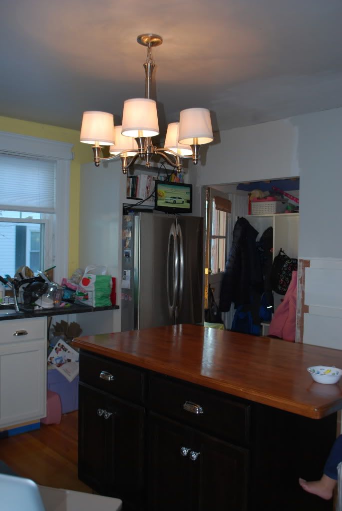

I have the birch ikea top, for my island. While I didn't stain it black, it wasn't the easiest to take the chestnut colored stain I did apply, and is a little uneven. It has 3 coats of Waterlox on top. In addition, my kids sit there to do their homework, and for sure you can see the imprint of just about every assignment they've had...It is a temporary solution for me, ultimately to be replaced with granite when the budget allows! Here's a photo of right after it was done

Angie-Be glad you didn't know and just run with the soapstone! =) Bellajourney- Thanks for the picture! Was the edging hard to do?
