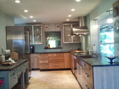

  • remodelfla
    We put the upper on first, then tiled, and lastly the hood. Here's a longer shot so you can see how it looks as a part of the whole.
