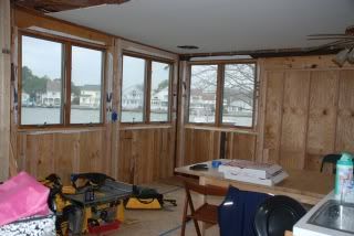

    Hi Fun to Learn. I am not sure if my answer exactly matches your question. With my Kitchen Remodel I decided to replace my old 30yr casement window with a larger window to attract in more light and better views. (the Contractor basically enlarged the opening by around 3ft w and 1ft H. I bought the window about a year ago for around $700, using the Home Depot no interest plan and paid it off in about 3 months. I had doubts about my choice because it was standard no frills anderson. The contractor that I am using gave me a price of $1750 which included installing the window plus finishing it on the outsie, wrecking out all the old plaster walls, lathe and ceilings down to the beams and rafters and taking down a non load bearing wall to open up my DR and Kitchen into one room. Prices really vary out there so my advice is just keep getting quotes. The less of a hurry you are in the better. I think the contractor that I chose was the least expensive but also the best of the 10 or so I got prices from. I thought this was very good value. It took him 3 days to do the work and he also jutted the window out about 12 inches to create a nice cottagy feel. His work gave me a nice 12" window sill which will be perfect for displaying pots of herbs or such... Plus his handywork with the way he finished everything changed the whole feel of the window. I think it helped that I bought the window ahead and so we were just talking labor. I would send a pic but I am still struggling with posting images. If I can finally get this working I will send you a pic.
    Also has your friend considered Craigs List. I have seen plenty of nice windows, used and new at bargain prices. Good Luck:)
