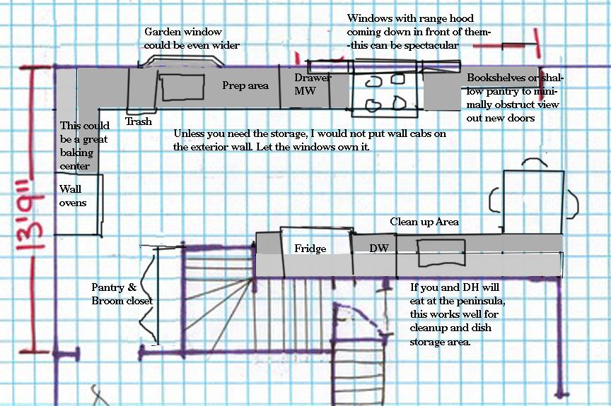

So I have my current kitchen area completely gutted down to the wall studs and even took out one wall already and am about to take out a second to open the kitchen area up into the family room. I desperately need help with my kitchen layout as the space is somewhat awkward (to me at least) and I am having problems deciding what the best layout is. I have included a scan of a basic empty floor plan sketch I just drew up. The kitchen area is the 24ft long wall area between the living and dining room. There is a staircase that curves down into the kitchen directly from the 2nd floor that is original and I will not alter it in any major way such as getting rid of it like my husband suggests we do. I can add windows and/or doors anywhere on the exterior walls and would like a sizely window on the 24ft wall (maybe above the sink) so I can look outside and see my horses. There was originally a door in the kitchen to outside when I bought the house, but am getting rid of it so didnt include it in the sketch. I also showed where a staircase goes from kitchen to basement through 2 doorways. I plan to close off the first door way from the kitchen down to the basement and make a solid wall because there is another doorway that will give me access to the basement door from inside the house. There is also more to the front of the house which includes a french door centered on the front, but didnt feel it was necessary to draw in the floor plan.
Without telling you too much to influence your ideas I would like to say that I will be adding french doors in the family room out to a deck on the same side of the house as the 24ft kitchen wall. I would like to have a peninsula I think for people to be able to sit at and converse with whomever is cooking in the kitchen. Also I do NOT want to put the stove in front of the staircase!!! I have a kitchen planner draw this scenario up once in a layout and I honestly couldnt believe she thought that was acceptable. Coming straight down the stairs into the stove just seems like a MAJOR safety issue to me. I hope I haven't confused anyone and REALLY need your help for a layout. I spent several hours the last few days trying to figure this out and havent found anything that I am just in love with so I am turning to the creative minds here. Thank you in advance and I look forward to seeing what you all have to say!!!

We will not be wanting a table/chairs in the kitchen. A peninsula with bar stools will serve nicely for eating/homework etc while my husband or I are cooking. No kids yet, but in the near future after the kitchen and rest of the house gets done I imagine there will be a few ;) Dining room is more a formal style dining room for large gatherings. Just my husband and I doing the cooking. Groceries and trash will go out the back door I want to put on the remaining living room wall after the 24ft kitchen area. We dont do anything more than an average family would probably. We make dinner every night, but arent extravagant chefs by any means. No computer or tvs needed in the kitchen. Small appliance storage out of sight is a must for my large stand mixer, toaster, blender etc. I would also like to do a large vent hood over the range and not an over the range microwave. I like having my microwave at a more useable height, counter height is what I'm thinking. I will try and add some pictures of the mantles etc for style reference later. On my way to the kitchen planner appt.
Maybe this will get things started.
I am not in any way a professional, but this was a lot of fun to play with. There are some wonderful pics on GW of ranges and hoods centered before spectacular windows.
Range and hood with window behind

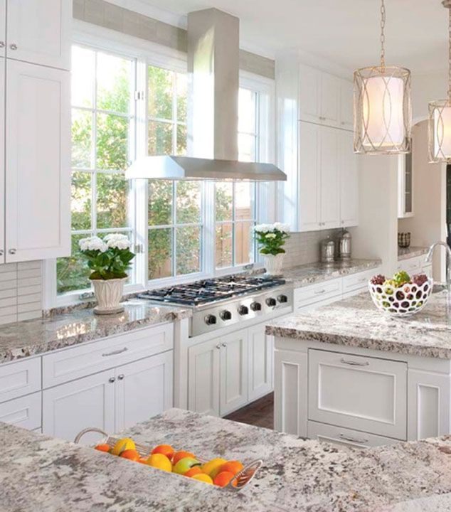

Barrelrider:
Here's a Houzz picture of a range and hood with a marvelous window behind them. This is what I was imagining in your space.

Oh my goodness!!! I really like some of the ideas you gave here! The "let the windows own the wall" is really fabulous! What do you think about the stove being so close to the family room though? I had it in the exact same spot in my last layout plan I drew up, but was unsure of it being that close to the family room.
The designer today suggested I use just from the stairs over toward the family room and use the corner area between kitchen and dining room for a small 3 or 4 person table with big windows in that area and one above the sink which would be on the 24ft wall. She wont do a 3D image without $1000 down on cabinetry. I suppose so she doesnt do all the work and have people take her design somewhere else.

I just have a minute to respond. Look at the stove in the pic I posted. With a good hood/vent, there will be no problem with smoke or odor in the family room and I think it is gorgeous from any angle.
Personally, I have no problem with the stove opposite the stairs. Actually, I think it would be wonderful to come down the stairs and see that stove, hood, and windows in front of me. So long as you have a water source on the same wall, I cannot imagine any problem--unless one of your future young-uns rides a bike down the steps and can't stop!
