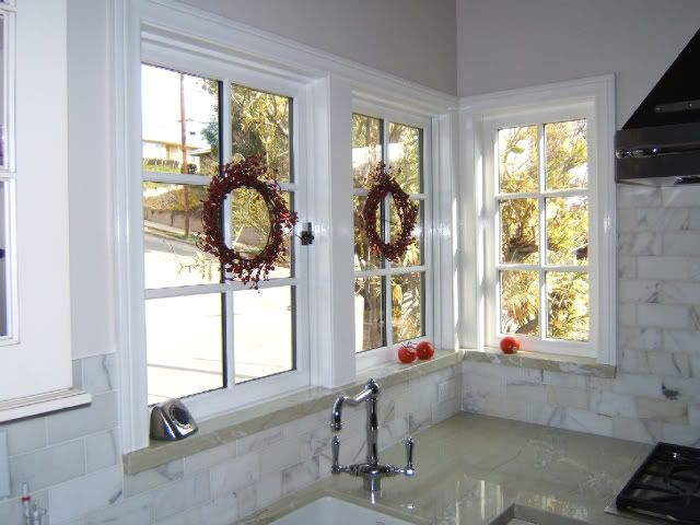

With a granite sill, you can have it built out to form a ledge if your window sill is shallow.
this one is a deeper sill:
and this one is a shallow sill:
Re; sill
Thanks for the pictures of the granite sill. were those windows installed when the kitchen was redone? If so, did you have to specify to the window person that you wanted to do granite sills so that they left a space for the granite? Just curious as to how it would work. I love the idea and will ask the granite person when the time comes.
If it doesn't work out, I'll just add on a 2" wide piece of window stool like I have for the rest of the wndows in the house.

RE: Show me your windows with tile instead of trim!!
I told my GC what I wanted and the fabricator worked the stone to fit the sills.
Sorry, I can't be more specific. The deeper sill window was already there before the remodel (and had tile over the sill), however, the narrower sill windows went in with the remodel.
