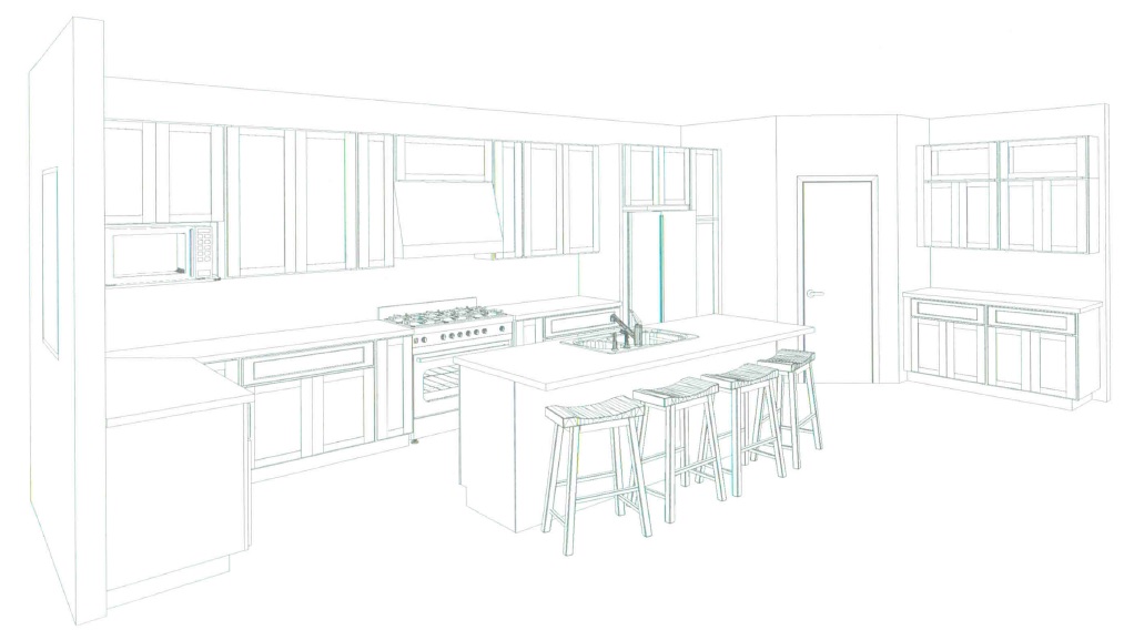

OK all, sorry for dropping this thread for a while, but i've worked with our builders and come up with an updated design I wanted to share with you and get feedback.
Here's an updated drawing of the top down layout:
and the straight on range wall view:
and the 3d sketch:
and going off of advice i received that we had too many seating areas along with helping us stay within budget, we decided to forego the banquette and instead do a mini lounge area. TV to be mounted somewhere on the wall that extends from the DR into the Kitchen.
pardon the hacking of that last image, the pantry gets lost in my attempt to overlay the top down sketch on our floor layout.
RE: Appliance/Pantry Placement
You have a lot of counter that won't be used under that window overlooking the deck. I predict it will become a dumping ground for people coming in those doors.
You added a large cabinet between the ovens and pantry that takes away valuable space next to the cooktop (as well as making things look unbalanced.)
I would also want drawers. And what is the new plan for dog food and coffee station? Do you have a microwave somewhere?
I can't tell what the sink size is, but it looks small for a kitchen this size as the only sink.
It's not that it's a terrible plan, these are just things that I would be thinking about.

Personally, I would get rid of the short leg of the L that wraps around toward the patio doors. That piece of counter will be awkward to use (especially in front of an appliance garage) and getting rid of it gives you better aisles for circulation. I would just have a straight run of cabinets across the bottom wall, which will eliminate the corner cabinet (hard to use, even with expensive corner pullout options) and the need for a seam in your counters. I would center the range along the back wall, and then do 1 of 2 options.
Option 1: Leave the wall ovens where they are, get rid of tall cabinet next to ovens, use a full height, 24" deep x 30" wide (assuming 30" ovens) cabinet on the far left side to balance the ovens on far right, which should leave you with approx. 4.5' of counter and cabinet space on each side of the range. If you are doing custom cabinets, you could even incorporate a flip-up door for an appliance garage in the middle of the tall cabinet (assuming you want an appliance garage, as shown).
Option 2: Put fridge where ovens are (far right), move ovens to far left, use a 6" wide pullout between fridge and wall and 12" wide pullout between ovens and wall, which should leave you with about 3.5' of counters and cabinets on each side of range (assuming space is 17' wide (hard to read) and you use a 36" range). Then use the space where fridge was shown on other side of pantry as a beverage and snack zone, with coffee maker and supplies, maybe an undercounter wine or beverage fridge, maybe a microwave drawer or small microwave in an upper. (The pullouts next to fridge and ovens could be wider if you find that more useful, I would just keep the one next to the ovens 6" wider to have symmetry around range -- assuming 36" fridge and 30" ovens. There have been some cool 6" wide pullout broom closets shown on GW as a way to use that filler space next to fridge.)
With either option, I would replace most of the lower door cabinets shown with drawers.

Thanks for the input everyone. I took the liberty to try to assemble option #2 by photoshopping my current renders. Here's the result:
I do like this render above, however I will mention one of the reasons we moved the fridge to the other side of the pantry was that we thought that area felt "disconnected" from the rest of the kichen when nothing substantial was there. Here's an older render showing just some cabinets:
By the way the sink size is 32" total, 30" inside diameter. I'm in love with the kohler sink below (link provided, scroll down page to see good pics) and would fill the island better, but I don't think the budget would afford it even though I think it would look great.

That's a huge sink! I love it too, but couldn't afford it nor did I have that kind of space for it. My sink is a 27" interior single bowl in a 30" cabinet. It is nice and big, I love it, but I also have a prep sink. I will say that I specifically designed my kitchen to have 2 separate water sources due to being a 2 person kitchen for almost every dinner. The sink was where we always got tied up in the old kitchen.
Your latest rendering is better. It still doesn't look centered, and I would play around with the individual elements to see if you can fix that a bit, personally. But not everyone feels the need for symmetry.
As to the fridge placement - I understand why you did that, but I have to disagree. You want a fridge to be on the fringes of the work space, but not so far out of it that have to walk around something from the work zone to get to it. Your former spot was sort of borderline. I could see it quickly becoming a pain for me, but it really may depend on how you cook and how frequently you cook.
I actually think that it is nice to have an area of counter for people to use that is outside the work zone. I have a similar space, but it is the wall opposite our "U" and has the fridge at the end. I have the toaster oven and electric tea kettle there as well as the MW drawer. It is also where dishes and glasses are stored. This way, 90% of what my kids want or need in the kitchen is located there, whether it is grab a snack or set the table for dinner. If I remember, you wanted a spot for the coffee maker and to store dog food. Seems perfect. The little bit of counter you had next to the fridge previously would have been useless.
