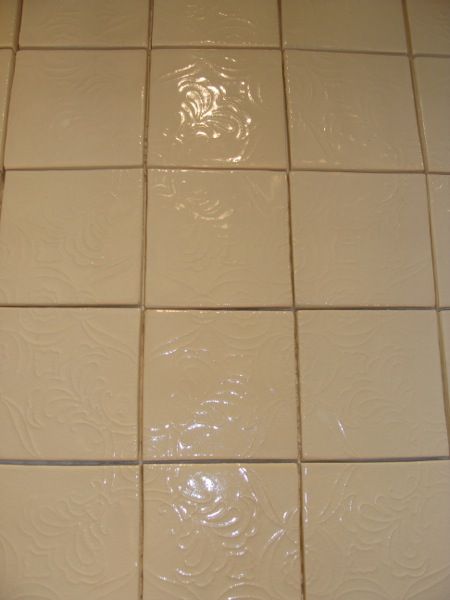

Our BS has a four tile pattern. I don't want a big grout line. GC's PM mentioned that they usually recommend 1/8" b/c sometimes too small can cause issues- may not be enough grout and sometimes tile ... now I forget the word he used but basically said there are sometimes issues. They will do whatever I want though.
Do you think 1/8" joint will be too big for my pattern?

Here it is with 1/8" apart: (my color is a bit different than these samples)
These SAMPLE tiles don't seem to be straight so I can't make them all equal but it's an 1/8" at the center point.
AND AT 1/16" AT CENTER POINTS:

I think the word he might have used was lippage? Sometimes if the tiles aren't flat, and/or square, when you try to put them too close together you get areas where one tile is obviously higher than the one next to it. You can google gardenweb lippage for some examples. Most tile manufacturers have recommended spacing for the specific tile. I would call your tile shop and get their advice. Their sample board seems to show it really tight but, who knows how many tiles they tossed in the trash finding perfect ones to make that board?
RE: Backsplash Today/Tomorrow- 1/8" or 1/16" Joint???
Although they do look tight, they don't look even. I think by spacing further apart, you won't notice the variation.
They are tiles after all, not a single ceramic sheet. You will still get the effect of the pattern with the spacing further apart and the installation will look better.

I think with the uneven tile you will need to go with the 1/8". It's LOVELY!!!!! I'm so looking forward to seeing it up and your reveal pictures. Please post progress pix today/tomorrow.

Hey Fishies, I love your tile! Yes, lippage would be the word. You can see it quite plainly in their own sample board. I have it in my backsplash and my tiles have less variation than yours. Lippage isn't always visible, but UCLs, depending on their placement, can reveal it alarmingly. I would think that 1/8" would give the tilesetter more leeway to give you a more level surface. Can't wait to see the finished b/s.

Can't wait - love tight grout but think you need 1/8 with your tiles.

soooo exciting! 1/8 since there is variation is what i would do (if some ended up at 1/16, they will just need to use unsanded grout).
