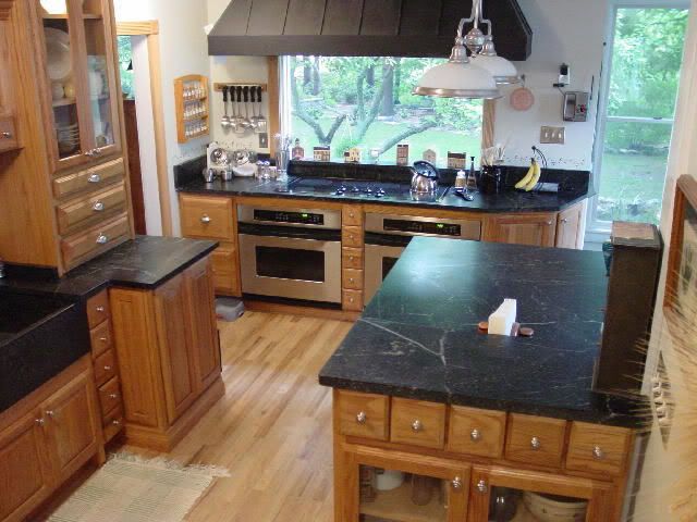

Here's one boxerpup posted on another recent thread:
Soapstone Pictures, Images and Photos
