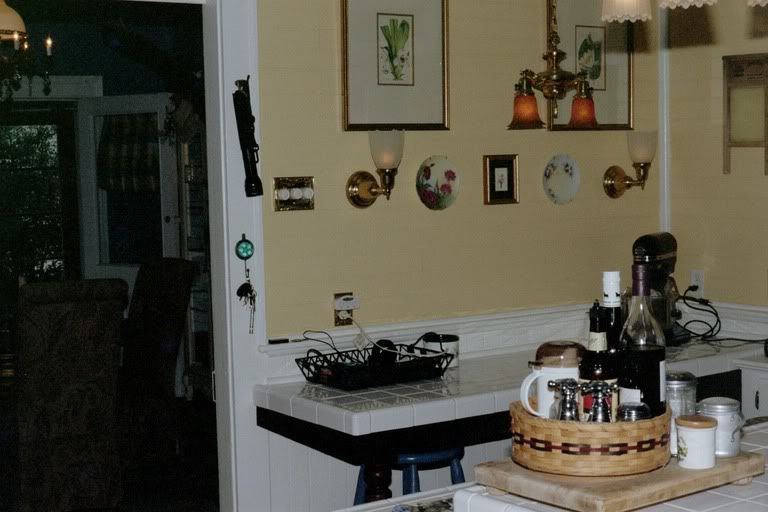

Pictures of our 140 year old beadboard in our kitchen. We have it on the ceiling, walls, and wainscoting. They are original to the house and individual boards. There has been some separation over the years, but nothing that a little caulking couldn't fix. When we remodeled our kitchen about 6 1/2 years ago, we had to replace about six boards in the ceiling. Found them at Lowe's, tongue and groove. Not a perfect match, but good enough.
href="http://smg.photobucket.com/albums/v311/Hoosier7/?action=view¤t=FH000008.jpg" target="_blank">Photobucket
