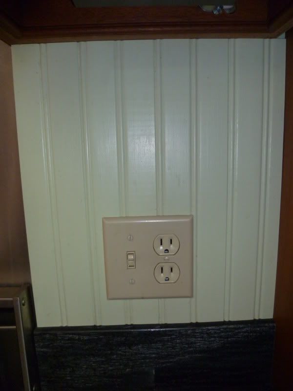

    We've been using our kitchen for about 5 1/2 years--and the beadboard backsplash has been up for at least 4 1/2 of them. It's worn very well. The paint has cracked in some of the grooves but the only reason I noticed is because I just went now and specifically looked (and snapped the close ups.) Surprisingly, the beadboard next to the range is not cracking at all. The first close up is behind the coffee pot and the second is next to the range.
    Dh primed all sides of the beadboard before putting it up. I can't remember the exact dimensions of the material he used--something like 4 or 6 inches wide and 4 or 5 feet long. We used BM paint--possibly the pearl finish.
    {{gwi:1589642}}
    13 years ago
    I have had tounge and groove beadboard backsplash for almost 2 years now and have really like it except for how much the seams show in the winter. It is painted in Ben Moore's Linen white semigloss and cleans up easily. I did paint the grooves prior to install but each of the past two winters the seams stretch apart and it looks sort of crappy. We have considered replacing it with one of the better quality sheet beadboards that has deep grooves but it will be a fairly big job because we also have it in the back of our hutch and I am worried about the damage from tearing out the existing stuff that is nailed and glued. Positive note is that the boards are half inch thick and have no warping. I love the look but would only use true tounge and groove again if it were stained not painted, the blacksplash is just too in your face to avoid seeing the gap movement. Also, I just painted the bare edges on the sides and had pieces of 1 by 1 put on the 2 upper sections near the window to form a tiny ledge that finishes off the top.
    This is one of the best pictures I have of ours:
