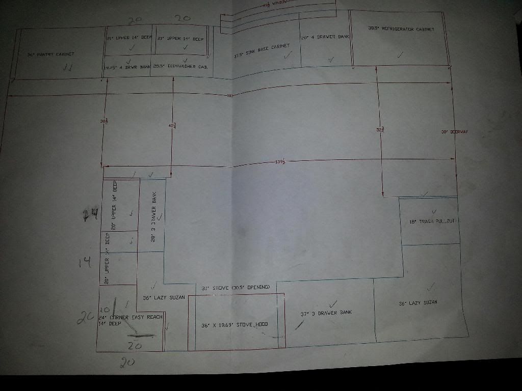

    Here is the final the layout we settled on after many, many variations. We are DIY'ing most of this so the layout may not be as professionally drawn as many I have seen on here. I hope you can make it out. The top right corner is where the door is and the large pantry is supposed to go.

    Where does the opening to the right lead to? If that's your family room space it would make more sense to have the peninsula there, with the fridge across the aisle. You could put your range to the left of the sink, scoot the sink down to the right under the other window, and place a window to the left of the range. Right now, all of the traffic goes through your danger zone between the sink and range, and that would fix that. Then the fridge could have a MW cabinet (either an upper or a base MW cab). with a run of counter between it and a pantry. You'd end up with a much better protected work zone and a much more social kitchen as well.

    live wire oak...what you can't tell from the pic is that the right bottom corner is completely open to the dining room and living room...from about 3" to the right of the range hood all the way around the corner to about 10" beyond the trash pull out will be a half wall with a two level counter. Opening up the kitchen was the #1 reason for this reno, with additional storage and counter space being #2. The counter top you see in the first pic is the only counter space I had in the old configuration. Talking about it today with my husband, I can't figure out a way to keep it a window while maintaining enough storage so unless someone has a groundbreaking idea, we'll probably stick with the current plan.
  • Gracie
    Am I reading that right that you have the sink all the way across the room from the stove? Is there an island with a prep sink not shown? Have you had the talented people here look this layout over for you?
