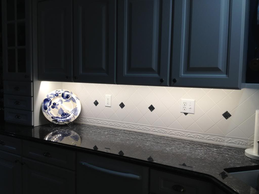

  • autumn.4
    Tricia - not sure what kind of view you wanted. LOVE LOVE LOVE the UCL. I can't believe how much we use it now that we have it. They are used daily (ours are on a dimmer and we use that as well).
    Lights off:
    Lights on:

  • autumn.4
    deb-you can see our 'dots' if you look too!
