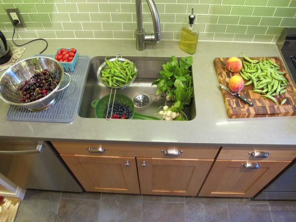

    Sink side (we're getting a wide sink as well)

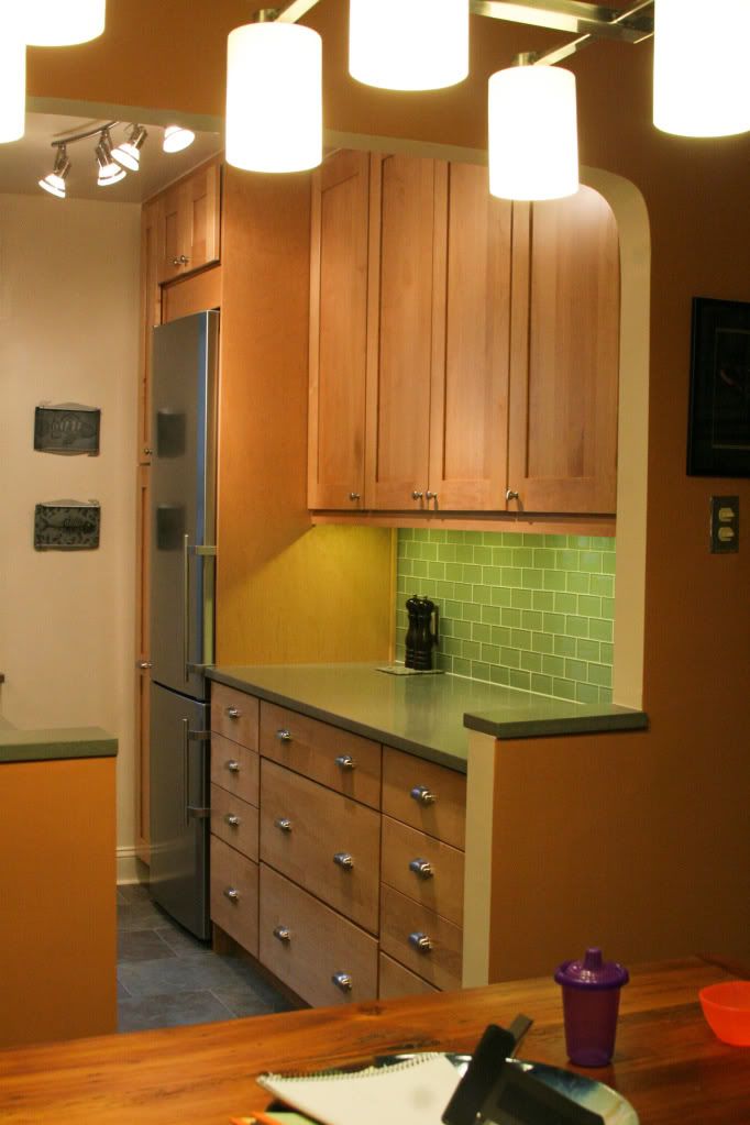

    I too have a galley kitchen and my layout is almost exactly as you have planned - DW then sink then trash pull-out (including compost bin) with silverware drawer above it (with a double-stack inside). I love it! I also put my other recycling - paper and glass/plastic under the sink so I like having all of the recycling and trash together in one zone. Next to the pull-out I have my range with OTR microwave which I also love although I don't think an OTR is what you are going for. Here are some pictures post-renovation.
    I also agree that you will be happy regardless of where you put your pull-out because the galley is so efficient with everything so close. I just like to prep at the sink with the pull-out open for easy clean-up.

    Wow...this is all so helpful! Ok, so yes, we do have a disposal and now that I'm thinking of the way I prep: i tend to prep next to the sink even though I have more countertop next to the range. The other times I use the trash is whenI'm washing dishes so I'm thinking I should keep it next to the sink. And now that I know more of you have a utensil drawer right under, I'm feeling good about it.
    The dishwasher moving is interesting....but I'm thinking I'd rather break up the stainless and maybe it's better if my 2 and 4 year old didn't have good access to the trash as they tend to start playing with the pedal, making it talk, etc.
    So microwave is interesting. I feel like I'd rather just put it in a cabinet so it's not customized at all for the micro. That way if we need to change it in a few years, I'm not worried about the size. Now, my only concern is will I hate bending down? My reasoning was that its higher than the oven racks So how bad can it be? Plus, we are not a tall family...but I'm curious about how people who have lower microwaves feel...
    Brooklyn - love your kitchen. It's what we want in different colors! Can you show me a wide pic of the other side and share anything else you love/not love about the setup/sizing/etc? Is that caesarstone? We're getting raven caesarstone and it has the same texture....

    Tricia -
    In my earlier message at the bottom is a link to all the photos of my kitchen after the renovation - that post has all of the details and photos you might be interested in.
    Yes, we have Caesarstone - Rosemary (a color now discontinued - sadly) and love it! The Raven you have chosen is beautiful.
    I love my kitchen and have yet to find something I would change! I spent a ton of time measuring and trying to find a home for everything before deciding on a final layout (I found this part fun) - if you haven't done this already, I highly recommend it.
    Also, I too have a pre-schooler (just one - age 3.5) - she has her own drawer - the first base cabinet on the right when you walk into the kitchen - at the bottom of a row of 4, 18" drawers in the picture below although it's slightly blocked - the drawer keeps her busy and involved in the kitchen - it's been a ton of fun! Just a thought as it might work for your two kids - being at the start of the galley, it keeps her from being under-foot and/or too close to the hot range.

    Sorry Brooklyn - missed the link the first time. Your kitchen is a perfect use of space and exactly what we're aiming for. I was thinking of putting a 4 drawer base cabinet at the end as well and now I know it looks great. I actually am putting in 3 toe kick drawers in that run and told my 4 year old she gets to have one of the drawers. She already has a plan!
